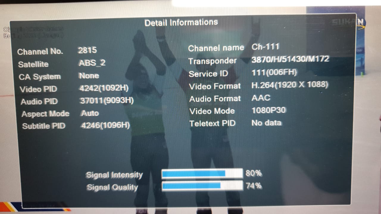

Postby wie69 » Thu Apr 28, 2022 10:36 am
thank you for your reply..
yes, i can receive other frequency both H/V at this ABS 2 75East.. with RECEIVER GTMEDIA V8UHD, V9 Prime, V7 HD, V7 Pro, even cheap receiver like XFLAT PLUS 9 and Hellobox 6 (old version).
MIS value i got from GTMEDIA V8UHD or V9 Prime ..
i need to know if TBS 5927 can handle symbol rate above 50K ??? does anybody confirm it ???

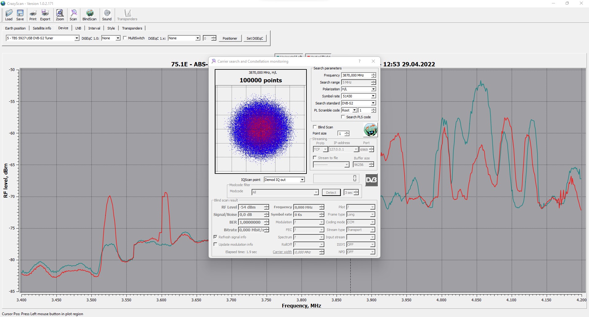

Postby wie69 » Thu Apr 28, 2022 12:38 pm
hello, yes i already try crazy scan, but no luck....

Postby DVB » Fri Apr 29, 2022 3:14 am
You've got a bit weird RF Level reads.
Please check if you've got the latest Windows drivers version installed 1.0.0.7.
For CrazyScan - try to use test release: https://sourceforge.net/projects/crazyscan/files/test/
If you did some changes to StreamReader.ini - try with default one.
5927 overally cannot go above 111.6 Mbit/s and will start to lose packets. The higher bitrate above that vaule - the more packets will be lost. Because if USB 2.0 speed limit. Limitation is not SR related and card in theory can go above 50000 ksps, but mostly 50000 ksps means also more than 111.6 Mbit/s - it's rarely used for DTH purposes and for data transmission complex modulations will automatically run above this limit. Your case is specific, high error correction rate might help.
Try to configure IQScan window in CrazyScan as below (remove BlindScan selection, put exact Symbol Rate, DVB-S2, then click on cat & fishes icon and show us the screenshot after a few seconds of running):
For usage on E2 receivers via USB, I've got no experience in this field.

Re: TBS5927 problem with SR above 50K
Postby wie69 » Fri Apr 29, 2022 2:12 pm
yes , i use the lastest windows driver version.
i did not nothing change anything on streamreader.ini
this the result you ask for..
