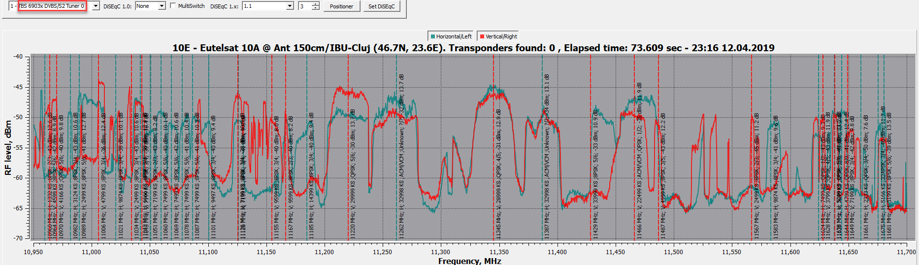

Postby satesco » Sat Apr 13, 2019 4:18 am
You probably do not have Crazyscan v.1.0.2.160 and one of the latest versions of StreamReaderEx(v.1.2.4.79) that were designed exactly for these cards,6903X & 6909X.Hats off,@CrazyCat :D
A test with this version on a satellite feeds-Eutelsat 10A at 10.0E and and on one with DTH signal-Astra 19.2E:
satesco

Postby crazycat » Sat Apr 13, 2019 7:34 am
aspirepy Wrote:Sorry friends, I was a lot work these days, so I did not comment on what was done with the blindscan tbs and the crazyscan, in relation to the blindscan tbs as I mentioned above it is very slow (I really do not know if this is for everyone) and the Crazyscan in its latest version does not work (not even start) from the moment I installed the TBS6903X card, maybe someone could enlighten us more on how to make a better blind search with this spectacular card, any suggestions friends ?. Thanks in advance
Use latest test builds CS + StreamReaderEx-BDA
http://crazycat69.narod.ru/sattelite/St ... Ex-BDA.rar
http://crazycat69.narod.ru/sattelite/St ... zyScan.rar
Fast blindscan (BLScan2) not implemented yet for STiD135-based devices (TBS 6903x, 6909x). Only classic step-by-step BLScan, slow.
Classic RFScan replaced with FFT scan, but still some buggy :)
