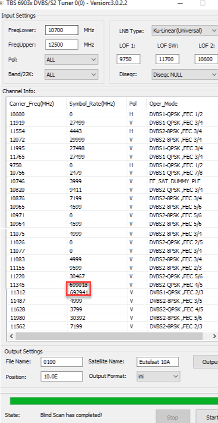

Postby satesco » Mon Apr 08, 2019 7:39 am
I'm afraid that it's a bug in this version of tbs blindscan.It's especially true when we have more feeds with different power signals.Scanning is slower with 6903X.
Here's what the parameters find on a satellite with many feeds,wrong both at frequencies and symbol rates.

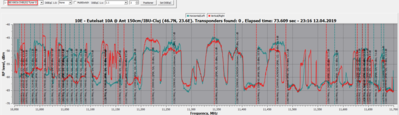

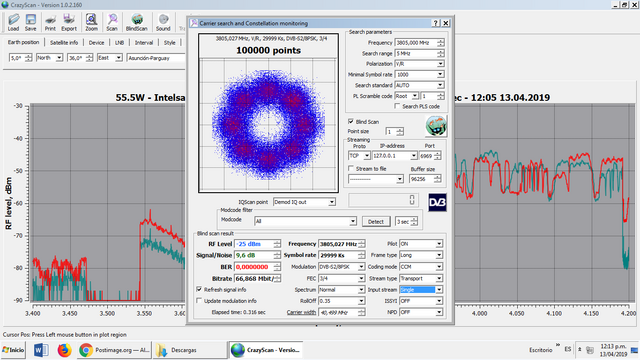

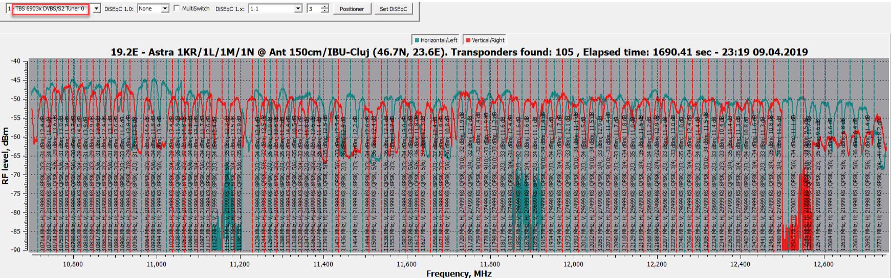

Postby satesco » Sat Apr 13, 2019 4:18 am
You probably do not have Crazyscan v.1.0.2.160 and one of the latest versions of StreamReaderEx(v.1.2.4.79) that were designed exactly for these cards,6903X & 6909X.Hats off,@CrazyCat :D
A test with this version on a satellite feeds-Eutelsat 10A at 10.0E and and on one with DTH signal-Astra 19.2E:
