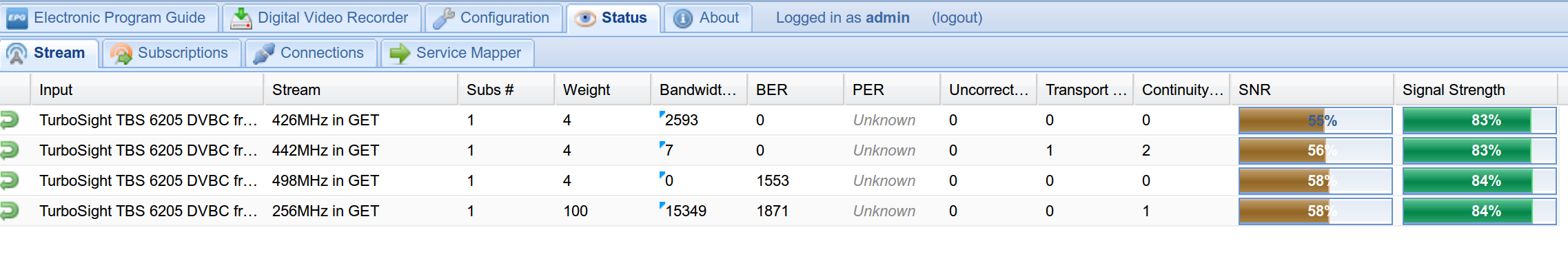

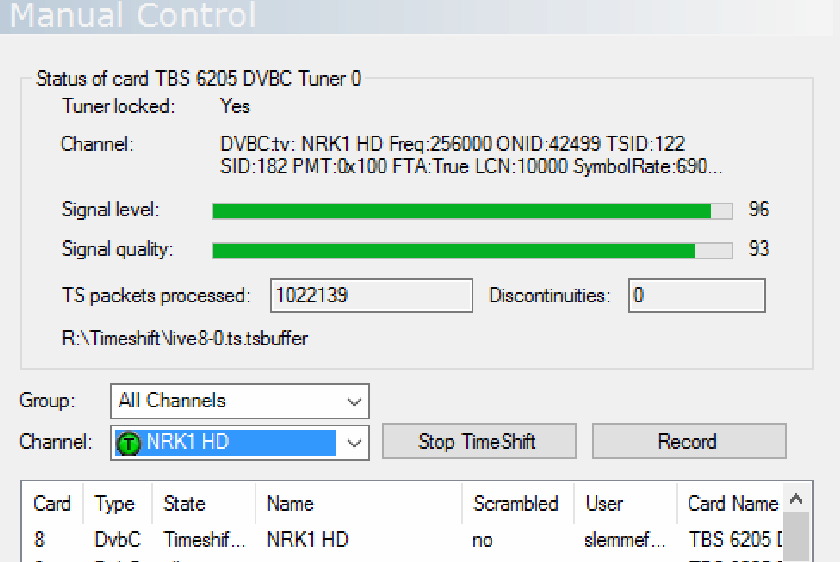

What I notice is that the signal quality seems to be less under Linux, causing slight problems and some continuity errors.
Under Windows using MediaPortal I see both signal level and quality around 95, while under Linux I see signal levels at 83-85 and SNR at 55-58. See attached screenshots.
Both systems are using the latest drivers from your download site - and I'm using DVB-C.
Any suggestions on how to improve the Linux driver quality?

the signal level in Linux is closer to the real one, not the one in Windows. in fact no signal statistics in percentage can be real, because the hardware measures that in dB and dBm and there is no such thing as dB and dBm to percentage conversion. that is also why you see those different levels - because in each os those dB and dBm values are converted to percentage with different "fake" calculation, but the initial dB and dBm retuened by the hardware are the same - you can be sure in that as your signal is the same.
on the other question about the continuity errors - do those increase over time in Linux? what i see is few such errors on your screenshot and that usually happens at the beginning when you switch to the mux - because there are data buffer from the old tune, here you can read:
viewtopic.php?f=168&t=9484&sid=29b42da94354043dc4b9a525775f30f5#p33882
how to tell tvheadend to make sure skip enough bytes after tune to new mux is made.

Postby andersh » Tue Dec 15, 2015 4:29 am
Thanks for the clarification on signal levels.
The continuity errors seem to appear at random intervals while watching TV.
Typical result from a 20 minutes session watching a single channel:

Postby andersh » Tue Jan 12, 2016 9:39 pm
And how do I obtain TransEdit? As far as I can see that is only available for registered DVBviewer installations. It was not included in the DVBviewer demo installation.
As I pointed out in my initial post, this was working fine under Windows with MediaPortal. I am now on exactly the same hardware, but running Linux and TVHeadend.
I just did a test, booting the machine back up in Windows and see that MediaPortal reports Signal Level and Quality in the 90s and I have no discontinuities at all.
