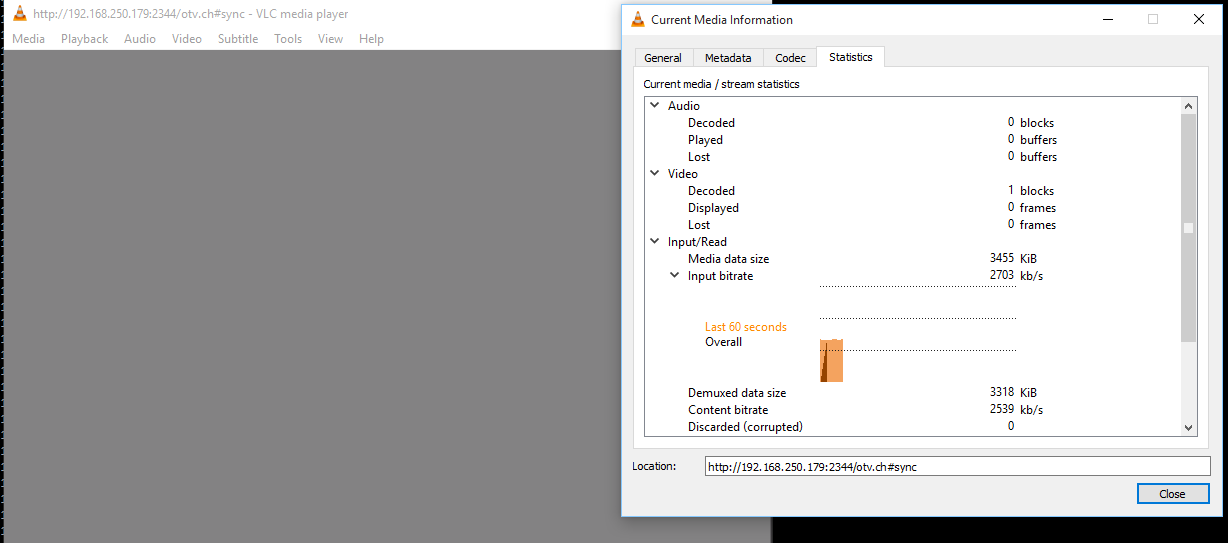

Postby phantomfx » Thu Nov 05, 2015 6:27 pm
Hello i have problem receiving channels from this transponder: Eutelsat 16E, 11366V 3/4 30000 DVB-S. Im using TBS 6991SE cards. Also, any other transponder whether is FTA or paid one is working without problems, but from this one i only get gray picture on VLC for every channel. I have tried with dvblast and astra, same thing happens.

Attached is picture from vlc. Also here is astra config:

I have tried Moi pro AMD and Moi pro, same thing happens. Using any other receiver, for example DVB-S/S2 IRD this does not happens.
