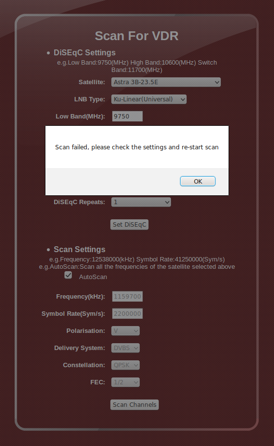

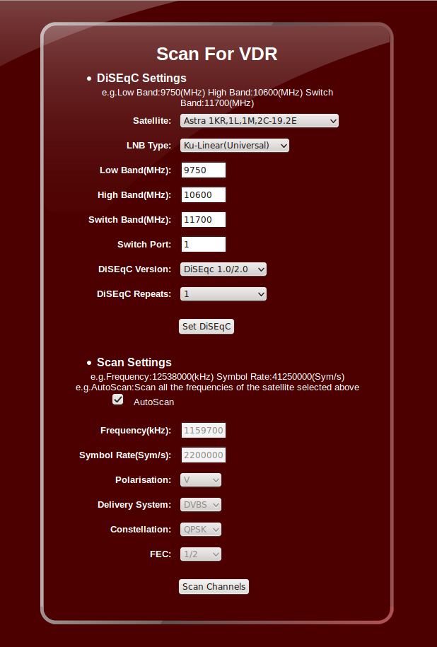

To scan for both Astra satellites, I first set the Astra1 in the upper part of the "S-tunning-settings.html" screen and press the "Set DiSEqC" button,
Astra 1 setting
then, I enter the Astra3 in the upper part and press the "Set DiSEqC" button again.
Astra 3 setting
After that, I press the "Scan Channels" button, with "Autoscan" checked. (see both images I uploaded) This process takes a long long time.
After 25 minutes, I get this dialog, and that doesn't make me particularly happy. So, what am I doing wrong here?

As one can see, it are Astra1 stations (compare with the other list) but marked as Astra3????
If I copy and paste the part of the command I see in TOP, starting with the scan-s2 part, like this;
scan-s2 -a 0 -O S23.5E -l 9750,10600,11700 -x -2 -o vdr -U -X /usr/local/dvb-s/test.ini
This I paste in the ssh terminal screen, I get this error:
[root@moi dvb-s]# scan-s2 -a 0 -O S23.5E -l 9750,10600,11700 -x -2 -o vdr -U -X /usr/local/dvb-s/test.ini
API major 5, minor 2
ERROR: Cannot open rotor configuration file 'rotor.conf'.
scanning /usr/local/dvb-s/test.ini
using '/dev/dvb/adapter0/frontend0' and '/dev/dvb/adapter0/demux0'
initial transponder DVB-S2 12736000 V 4937000 3/4 AUTO 8PSK -1 0 0
----------------------------------> Using DVB-S2
>>> tune to: 12736:VC34M5S1:S23.5E:4937:
DVB-S IF freq is 2136000
WARNING: >>> tuning failed!!!
>>> tune to: 12736:VC34M5S1:S23.5E:4937: (tuning failed)
ERROR: initial tuning failed
dumping lists (0 services)
Done.
