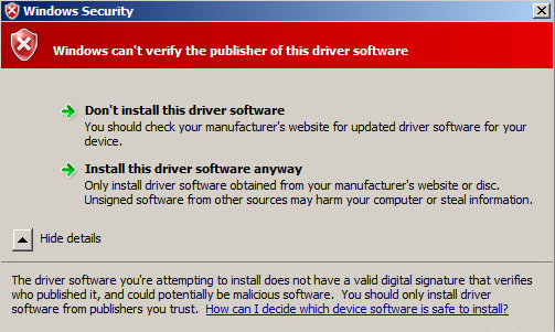

Thanks luchy, I've just installed the updated 1.0.3.2 driver. During the installation I received a "Windows Security" error, see attached. I clicked "Install this driver software anyway" to continue with the driver installation. As a test, I tried a couple of channels and all seems fine. I will be in touch if I experience any issues.
