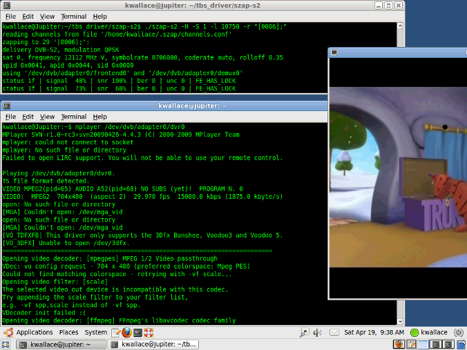

So now, I have both basic and detailed entries in channels.conf. I run szap-s2 with a detailed entry and while it is running, I bring up mPlayer: 'mplayer /dev/dvb/adapter0/dvr0' which should return the attached screenshot.
I still have some (a lot of) channels that will not play. In comparing the Lyngsat and Global data, it looks like mPlayer only plays channels labelled as mpeg2 or mpeg2/HD, otherwise mPlayer sits waiting to get something it likes.
Screenshot of working TBS6982 with Ubuntu 10.04 and mPlayer
