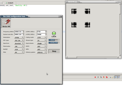

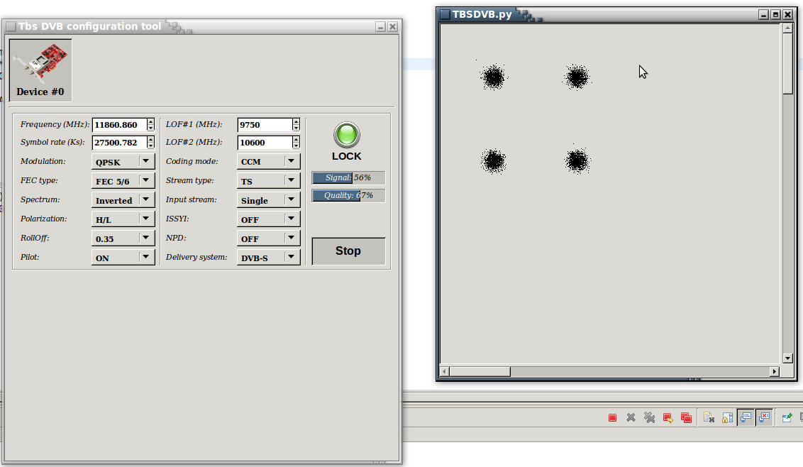

Hi there, I'm trying to draw constellation diagram for my tbs6925 card. I'm using s2-liplianin-v37 driver. My question is about the visualization. There is no problem when the modulation is QPSK but when i lock 8psk and higher something happened and the coordinates which i take are not normal. I post 2 screen shots QPSK and 8PSK. Thanks for the help in advance

however ... using your driver things are just perfect, you did best job, i've looking for solution for a long time to get FEC and MOD (every second). Thanks for the drivers tree. But i cant understand something - my result from FE_GET_CONSTELLATION_SAMPLES is array of long's couple (imag and real). Should I convert to other type or something elso for proper visualization. Thanks in advance...

I've tried to rebuild, but without any success. I'm curious is it normal to receive zeros (0) as a part of all array (imaginary, real). For example i have values != 0 for both imag and read, then stops and continue with zeros (imag = 0, real = 0). After this part I receive again (imag != 0, real != 0). Does anyone can help me with that.
