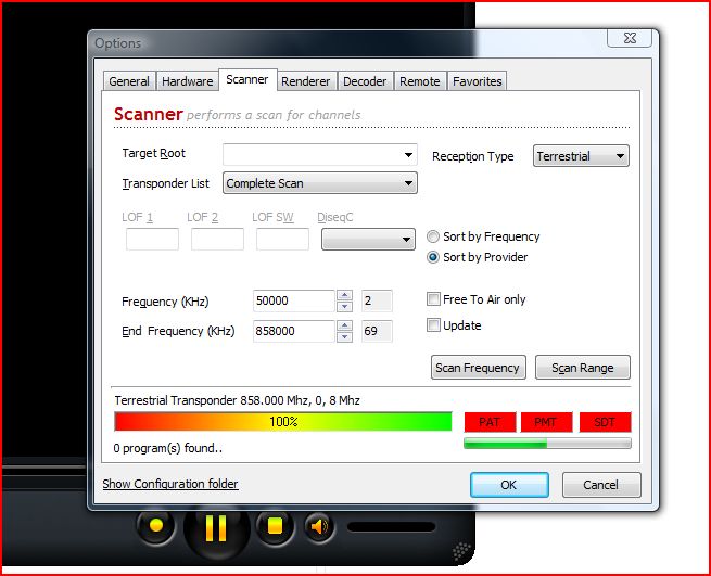

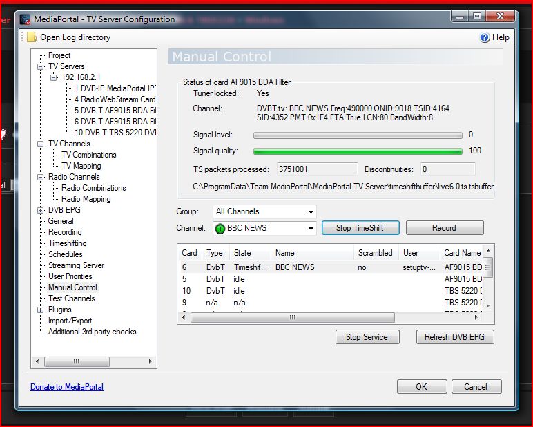

From these pics you can see that AF9015 has no problems with signal but 5220 can't get a signal lock.
