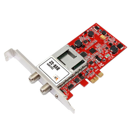

I want a receiver that can do both C/Ku band, mpeg2, mpeg4, SD, HD, DVB-S, DVB-S2, 4:2:0, 4:2:2, 1080P thru my HDTV basically everything that's out there. The specs don't mention C/KU. In fact I saw posts on the internet that say it doesn't do both C and Ku. And the specs don't mention 4:2:0 and 4:2:2. The picture shows TWO connectors for cables. I assume the one is in. What is the other? Are those the only two connectors? If this could also take RF in from my set-top box I could piggyback my cable in and other satellite in into this card and watch it ALL on my computer. It'd be even better if I could send input thru my other boxes (including VCR) and into this card so it could double as a sort of vid-cap card. Anyone know anything about all this?

In fact,all of our tuner can do C and ku band,and can you share the picture which you see?

The image I referred to is here: http://www.tbsdtv.com/products/images/t ... 6925_2.jpg
There are two connectors. One must obviously be from the lnb(s). What is the other for?

The other connector is for loop. You can use it to share conection of lnb in to to other card or dvb receptor.

Regarding the other connector on the 6925, so it can't be used to plug into the coax (modulated) input of a TV or a VCR or DVD recorder? Are you saying it is simply a pass-thru?

no, its just as stated. a pass thru.
the signal coming into the tuner is the exact same signal leaving through the pass thru.
