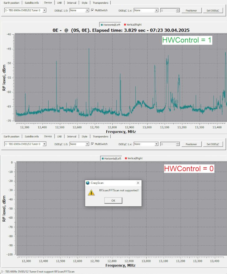

I've tried setting HWControl=0 in StreamReader.ini as suggested by @crazycat, but cannot FFTScan across any of the 8 tuners. It also appears to disable the BlindScan capability? With HWControl=1, Tuners 0, 1, 2 and 3 can scan as expected. Am I missing something?
Given the integrated nature of the STiD135's narrow band demodulators, would it still be possible to arrange them as virtual tuners with StreamReaderEx-BDA?
CrazyScan with TBS6909X V2 — HWControl@StreamReaderEx-BDA

Re: TBS6909X V2 — Bluescreen with SYSTEM_SERVICE_EXCEPTION e
Postby crazycat » Thu May 01, 2025 3:21 am
Only first four virtual demods have FFT cell, sо support FFTScan
I'm wondering if simultaneously using two different applications on the tuner card is causing it to crash and whether it would be possible to do so without it crashing.
This fantastic :) Only one StreamReaderEx-based app can be used with 6903x/6909x
Posts: 586

Postby betasat » Fri May 02, 2025 5:45 am
crazycat Wrote:Only first four virtual demods have FFT cell, sо support FFTScan
I see; thanks @crazycat for clarifying. I had suspected the integrated nature of the STiD135 does not support running multiple applications simultaneously.
Is it possible to use a single instance of StreamReaderEx-BDA to access all 8 demods at the same time for signal monitoring and route their traffic via RTSP or similar to other applications like DVBViewer for recording?

Postby crazycat » Sat May 03, 2025 8:46 pm
you can use BDADataEx for signal monitoring + DVBViewer for streaming with all 8 demods
