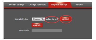

Postby daowei » Fri Feb 07, 2025 2:34 pm
Hi slirp,
Yes, unpack zip firmware package and then upload "update.tar.bz2". When it's 100% uploading, click "upgrade" and wait until 100%.
Last, need to reboot Encoder.
I'll share a photo about the "upgrade". If still does not work, please setup a remote check.
fw upgrade
