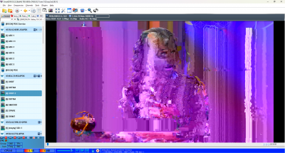

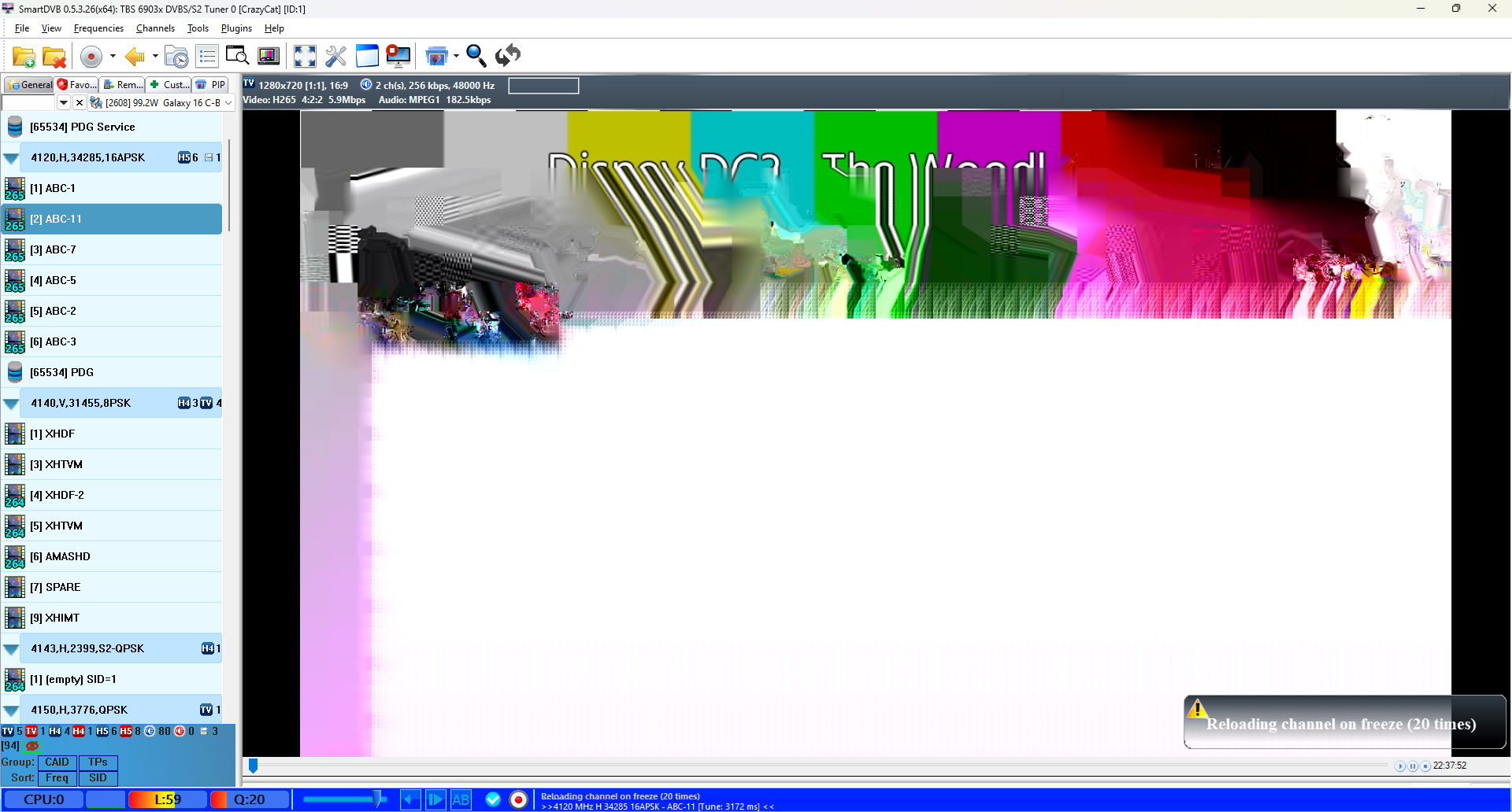

This is just a sample of all of the errors from Frequencies 3800 to 4200 both H & V polarities on all CBand satellites. There are no issues with KU Band.
Continuity Errors_01
Continuity Errors_02

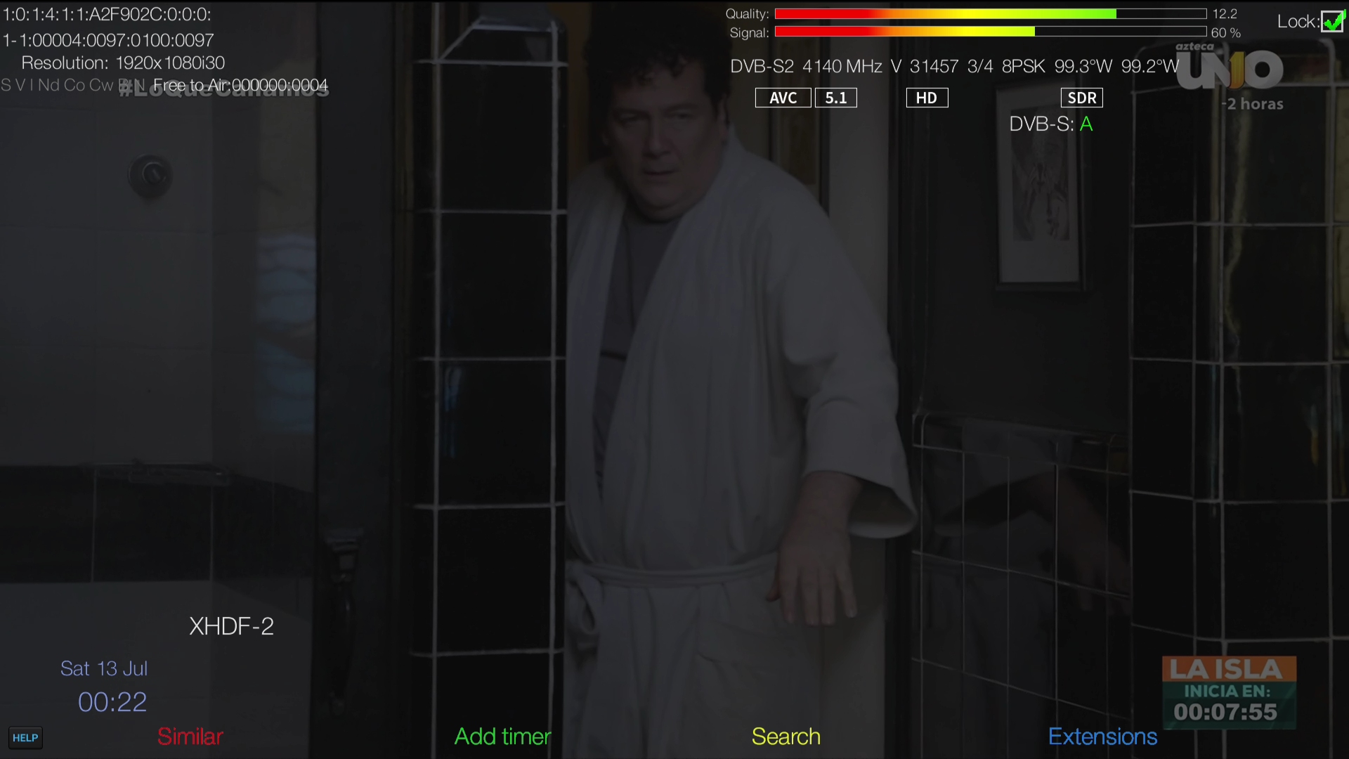

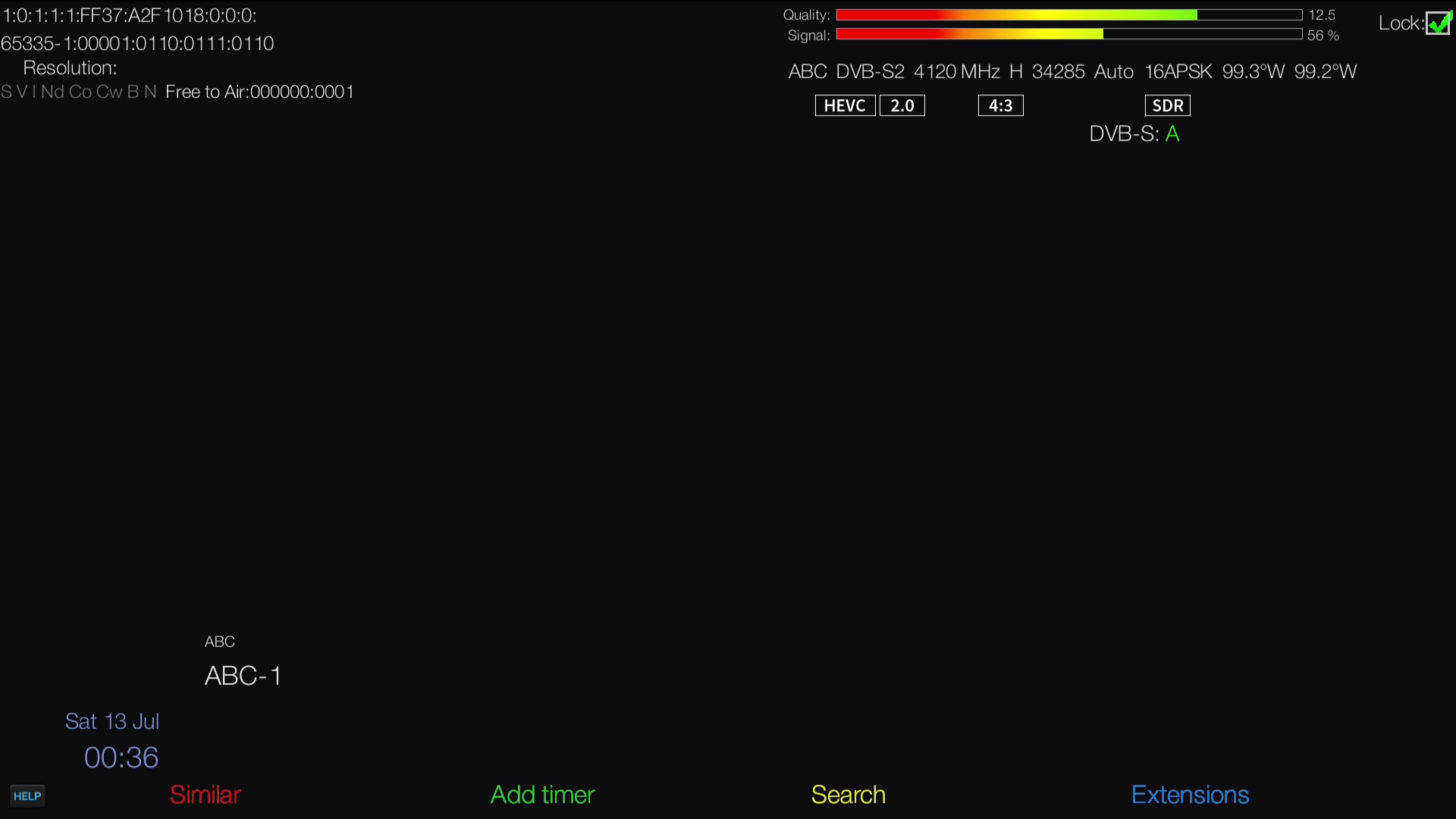

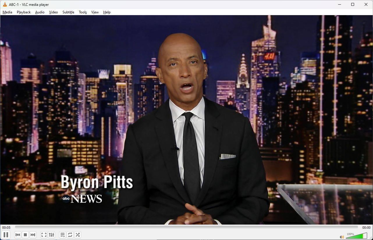

As I stated earlier, using Octagon SF8008, the CBand Signals display videos without issues, but the TBS6903X as shown earlier displays frozen and broken up videos and crackling audio with many continuity errors. See Octagon SF8008 Screenshots attached below:
Octagon SF8008 Displays Video without issues directly
Same signal streamed from Octagon SF8008 to VLC, and play perfectly without breaking up.
Notice a Solid SNR signal
Babadem
