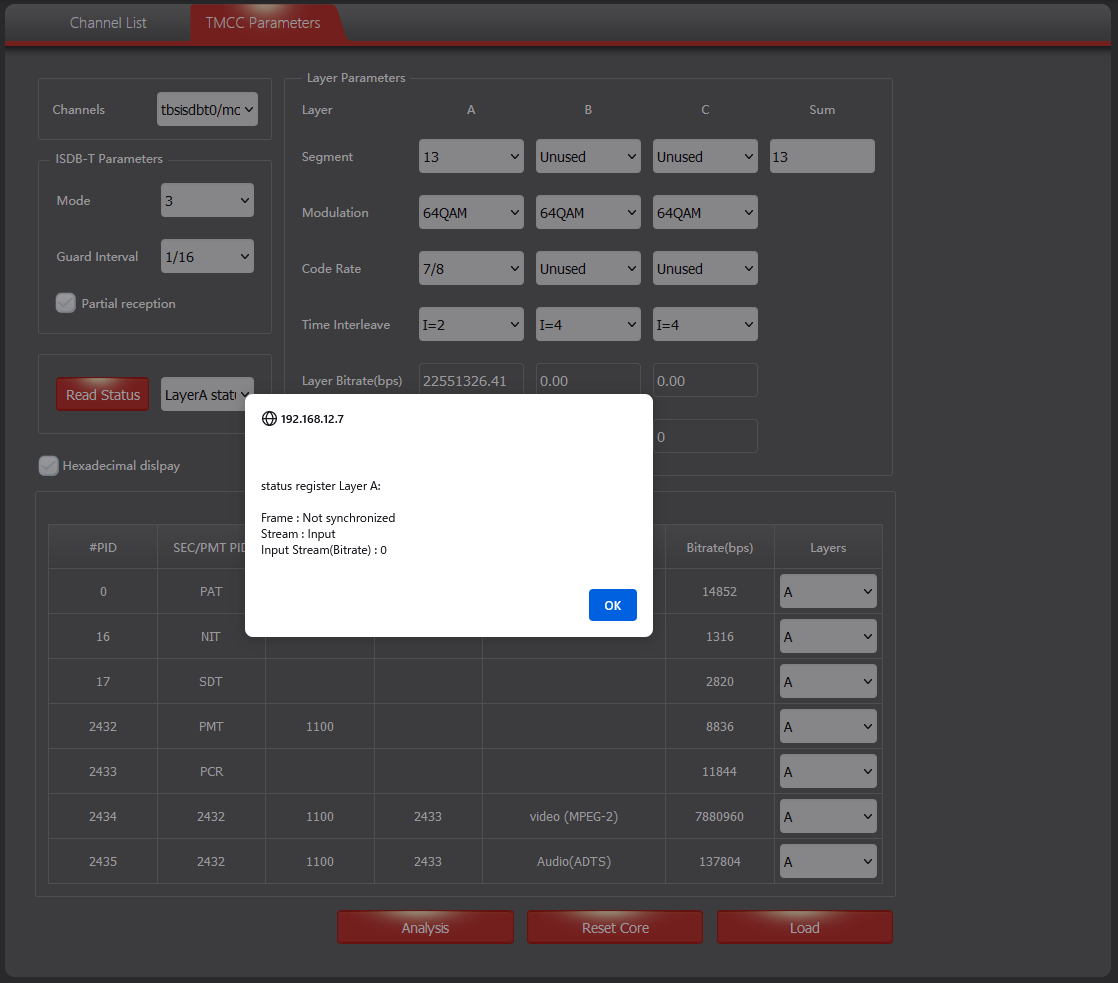

I purchased TBS6214 and finished the setup.
However, the RF output from TBS6214 cannot be received by the ISDB-T receiver.
I think the cause is that the Frame of the Layer A is not synchronized and the bitrate of the Input Stream is 0.
Please give me advice.

But, I have some questions.
(1) I use "Network TS" and "Local File" as input sources, not "TBS adapter".
So, the state of getfront.service and tvserver.service is inactive(dead). Is this OK?
(2) Japanese frequencies have an offset value and we need to add 1/7(=0.142857...). On the initial screen, the frequency is 474,480,486,492MHz. Does this mean 473.142857,479.142857,485.142857,491.142857MHz ?

Postby zhangchao » Tue Aug 31, 2021 11:55 am
hi ,
1. yes , the state of getfront.service and tvserver.service is inactive
2. just can set mod's fre 473.142 , mod1=mo0+6 mod2=mod1+6 mod3=mod2+6 will be auto add 6 .
please add skype jack_2431
best regards!
