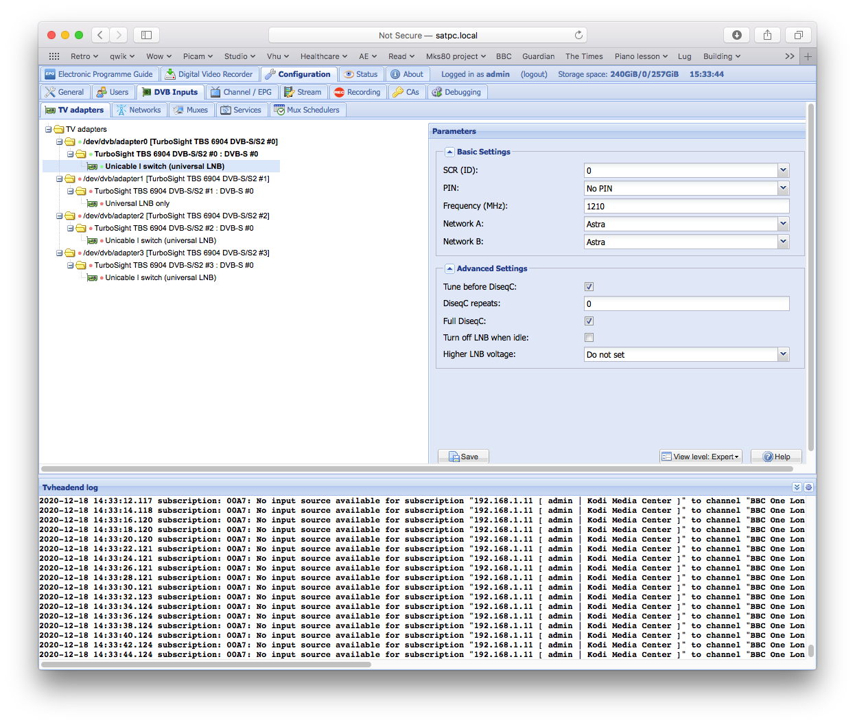

Hi Ive now got the 6904 working and want to change over to Unicable in TVheadend
I tried using unicable on one channel as shown in the image below but didnt receive anything from that channel after swapping to the unicable output on the lnb.
Is there something special to setup Unicable on the card apart from filling in the fields shown ?
Can you have one channel unicable and another universal lnb or must they all be the same ?

Postby steven » Fri Dec 25, 2020 2:20 pm
Hi Sir
From the picture you are using TBS6904 tuner 0 ,for 6904 which port you put unicable signal ? please take one picture
or you can setup teamview remote you can send remote id to our support@tbsdtv.com
we will have a remote check with this
and if windows works well then should be the setting issue .do not worry

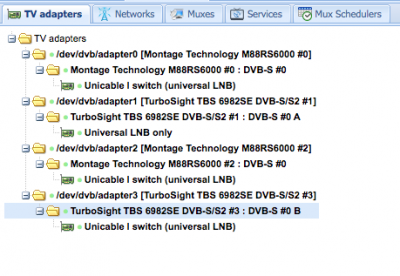

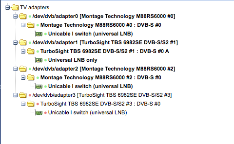

Postby Monstamac » Sun Dec 27, 2020 8:02 pm
Hi thanks for the reply.
I have managed to get a bit further with this and have put my findings on the TVHeadEnd Forum
I can use either card 6904 or 6982 with unicable on Windows.
I can use either card 6904 or 6982 with normal Universal LNB in Linux with TVHeadEnd
I can use the 6904 / 6982 at the same time as my dvbsky s952, my s952 works perfectly with the unicable on 2 tuners.
I can use the 6904 in Linux with Unicable in TVHeadEnd but it will not tune into all the channels it can normally, it seems to not like the HD Channels.
The 6982 would not work with Unicable in this setup.
My setup, the item that is disabled does not work with unicable so i have disabled it as I have no more wires.
Currently I am using 2 channels of Unicable on the dvbsky card and 1 channel of Universal on the 6982 as I have 1 cable of "unicable" which I have split into 2, and 1 normal LNB cable.
I would like to be able to use Unicable for both cards.

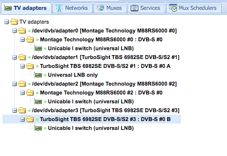

Postby Monstamac » Wed Dec 30, 2020 10:29 pm
Just thought Id let you know that I now have unicable working on the s6982 in Linux ( Tvheadend )
The only thing different, the weather is better and I changed a cable to the splitter.......
I havent tried unicable on both ports as I dont want to upset it and 4 channels at once is enough for me.
At some point I will make an alternate drive up and see if I cant get it working with Debian 10
Currently back at Ubuntu 18 and Tvheaded Stable.
