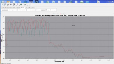

Postby Youknowme02 » Thu Dec 17, 2020 5:12 am
Youknowme02
Posts: 11
Joined: Thu Oct 15, 2020 9:03 am

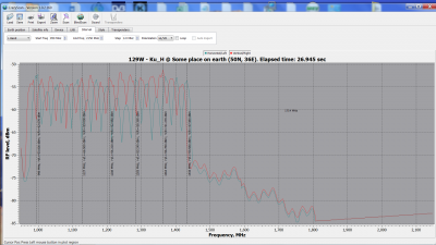

Re: TBS6903 Won't scan Circular
Postby Youknowme02 » Thu Dec 17, 2020 5:13 am
Here is no lock graph
Youknowme02
Posts: 11

Postby DVB » Sun Dec 27, 2020 7:28 am
Looks fine. Which satellite you are trying to receive? What will happen, if you press Blindscan button?
Now probably getting correct configuration should resolve your issue.
