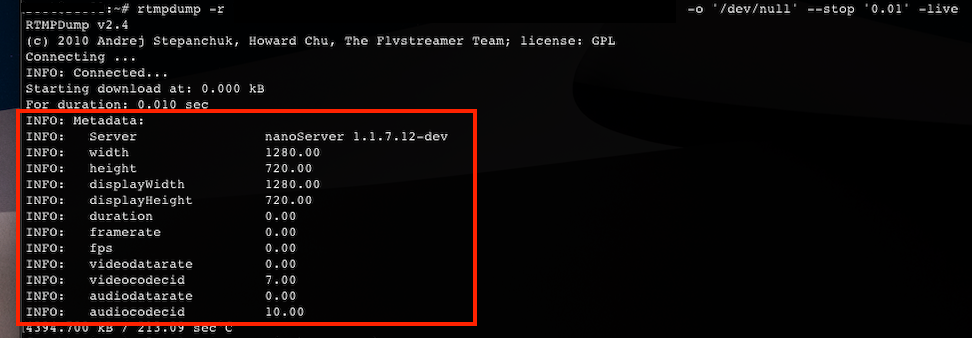

The RTMP Stream have *NO* Metadata inside, like: Width, Height, Framerrate, ect.
Many Players playing only a Blackscreen. Big Streaming Companies like Wowza, Nanocosmos analyzed the RTMP stream and say us, the RTMP stream has no MetaData inside. Thats a Problem for many players.
In the attachment i have add a Screenshot from a other Streaming Box. This Streams are working fine in ALL environments. Please see the MetaData information (get from rtmpdump).
The TBS2603 has a empty result with the same command.

See the Attachment, which MetaInformation are required in every RTMP Streams.

This is a working Box (Not the TBS2603)

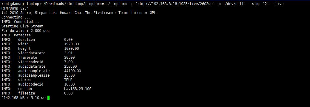

We'll talk with our Encoder Engineer, it's possible to add "Metadata" to RTMP stream. And another information is we'll release TBS2603SE(HD Encoder, support to 1920x1080 P_60hz, output: http, hls, rtsp, udp, rtmp) soon, it's another solution different from TBS2603 in ts packaging. So i think it's easier to add "Metadata" to RTMP.
And i checked TBS2603SE RTMP stream by FFprobe, please have a check. Sorry, rtmpdump is fresh to me and a little difficult for me to use it this moument. I think FFprobe should be same as rtmpdump in Metadata-checking.

This is the FFprobe log, please check it:
https://www.tbsdtv.com/temp/log.txt

Another, i'll send you the rtmpdump log informaiton of the new Encoder TBS2603SE, please check.
Posts: 141

yeah, your result looks fine ! Great job!

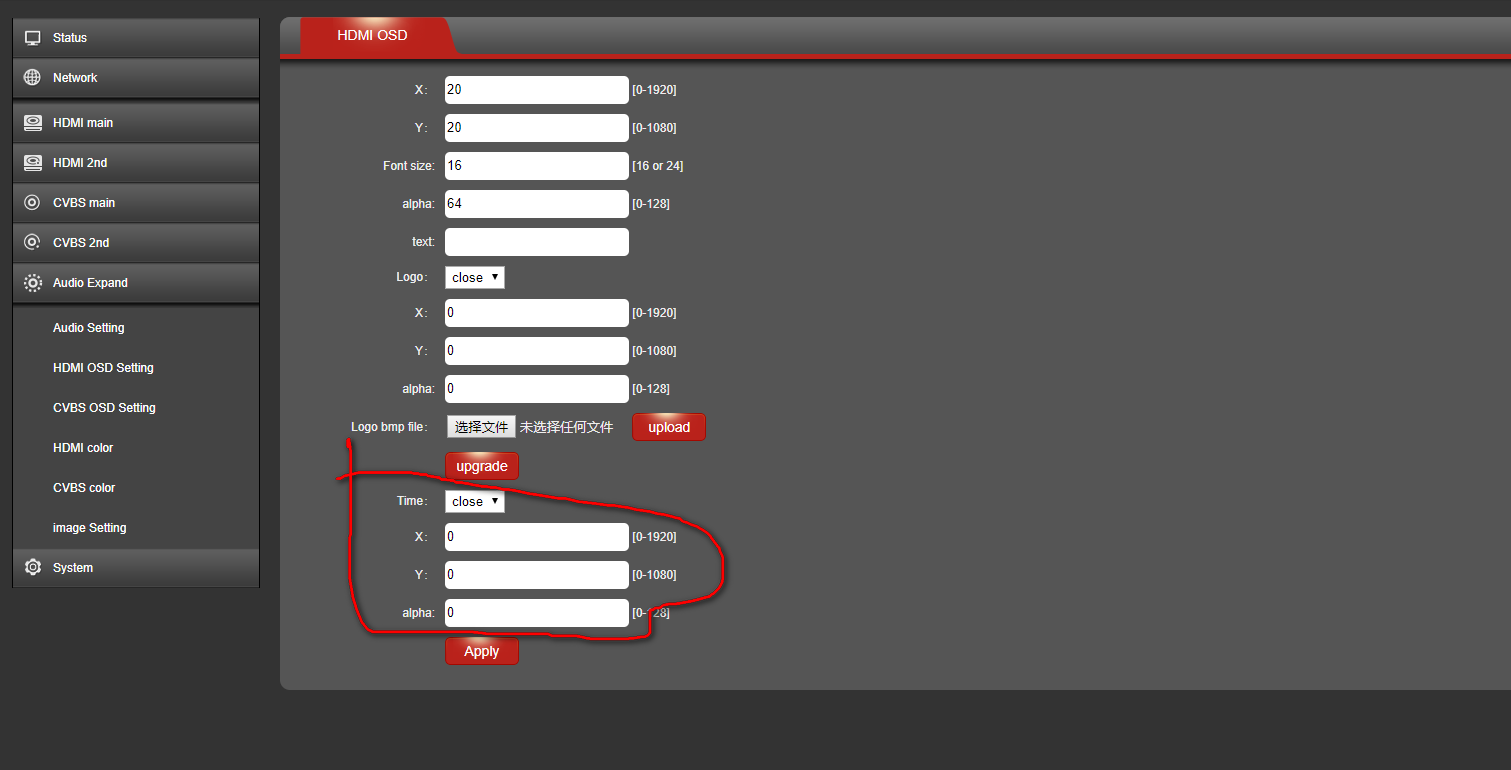

Postby echomay » Mon Nov 11, 2019 5:29 pm
You can open it in the web page:
