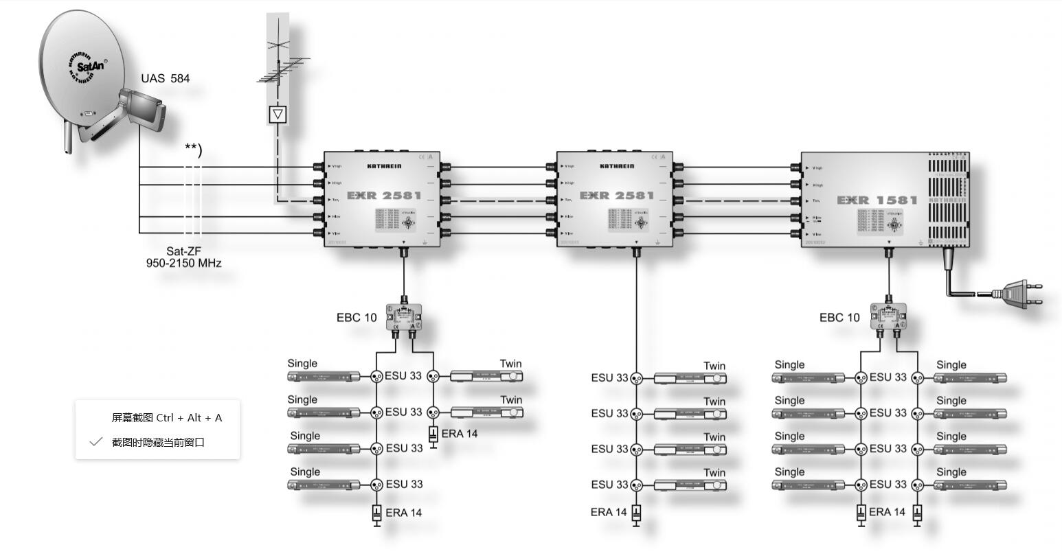

For the unicable device it is like need to use special spliter ,please have a try direct use the cable then lock id 1 ,1420 check whether is ok
the connection should be like this :
unicable
