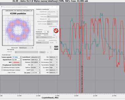

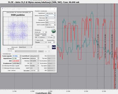

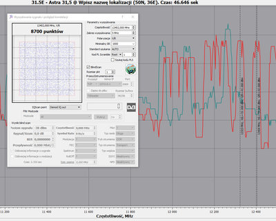

Hello.

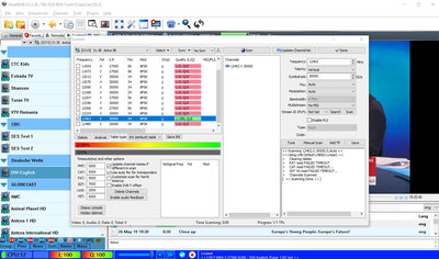

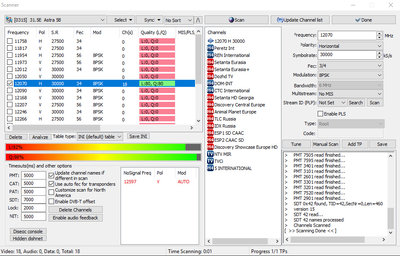

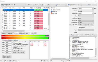

I have a TBS 5520 SE card, drivers 1.0.0.7, windows 10 and DiSEqC 10x1. The card does not work properly for me:
- on Astra 31.5 E he does not see transporders: 12050 V 30000, 12071 H 30000, 12323 V 30000, 12402 V 30000 and 12480 V 30000 (with the same installation another tuner receives these frequencies very well, for example SKYSTAR HD2 card),
- often when you try to tune a given frequency, it jumps to another adjacent frequency,
- I have a problem with starting the card - in order for the card to get a signal, it is often necessary to use the TBS5520se_ChangeMode_Tool_V1002 tool several times or switch the card on / off several times.
The above errors are caused by malfunctioning card drivers. Therefore, the question is when will the stable drivers for this card be released?

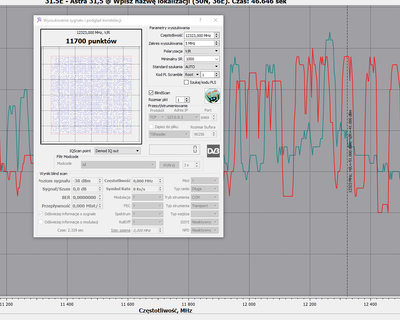

TBS 5520 SE
TBS 5520 SE
TBS 5520 SE
TBS 5520 SE
TBS 5520 SE
TBS 5520 SE

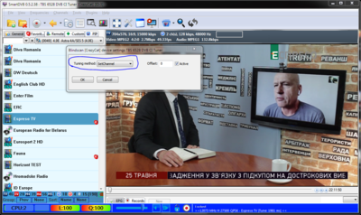

Postby crazycat » Sun May 26, 2019 3:27 am
files from this archive replace files over last 0.5.1.38 release (portable)
SmartDVB32-0.5.2.37ArchiveBeta1.zip
SmartDVB32-0.5.2.38.zip
Also better update StreamReaderEx
Select CrazyScan Blindscan device Tools->Device and set Tuning method in Tool->Device settings
Posts: 586

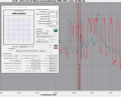

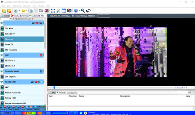

Postby brontowasik » Mon May 27, 2019 1:24 am
Thank you @crazycat.

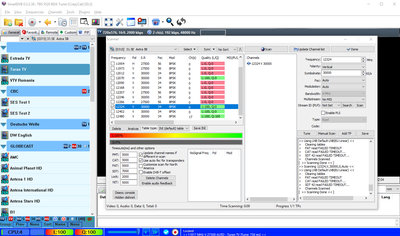

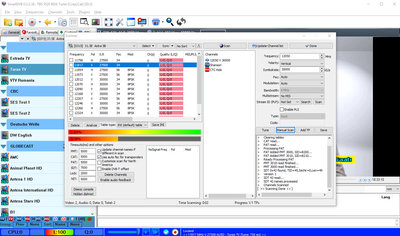

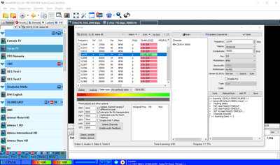

Unfortunately it does not work. In SmartDVB version 0.5.1.38 - Device settings function does not start. In SmartDVB version 0.5.2.38 also does not see the Astra 31.5E transponders: 12050 V 30000, 12070 V 30000, 12323 V 30000, 12402 V 30000 (only transponder 12480 V 30000 work). In addition for example transporder 10758 V 27500 and 10796 V 27500 not working on Hot Bird 13 E (after selecting the channel in SmartDVB from these transponders, SmartDVB turns off) and other errors appear.
12402 V not work
12480 V 30000 it works
12323 V 30000 not work
12070 H 30000 not work
12050 V 30000 works with errors (no change)
12050 V 30000 scan
