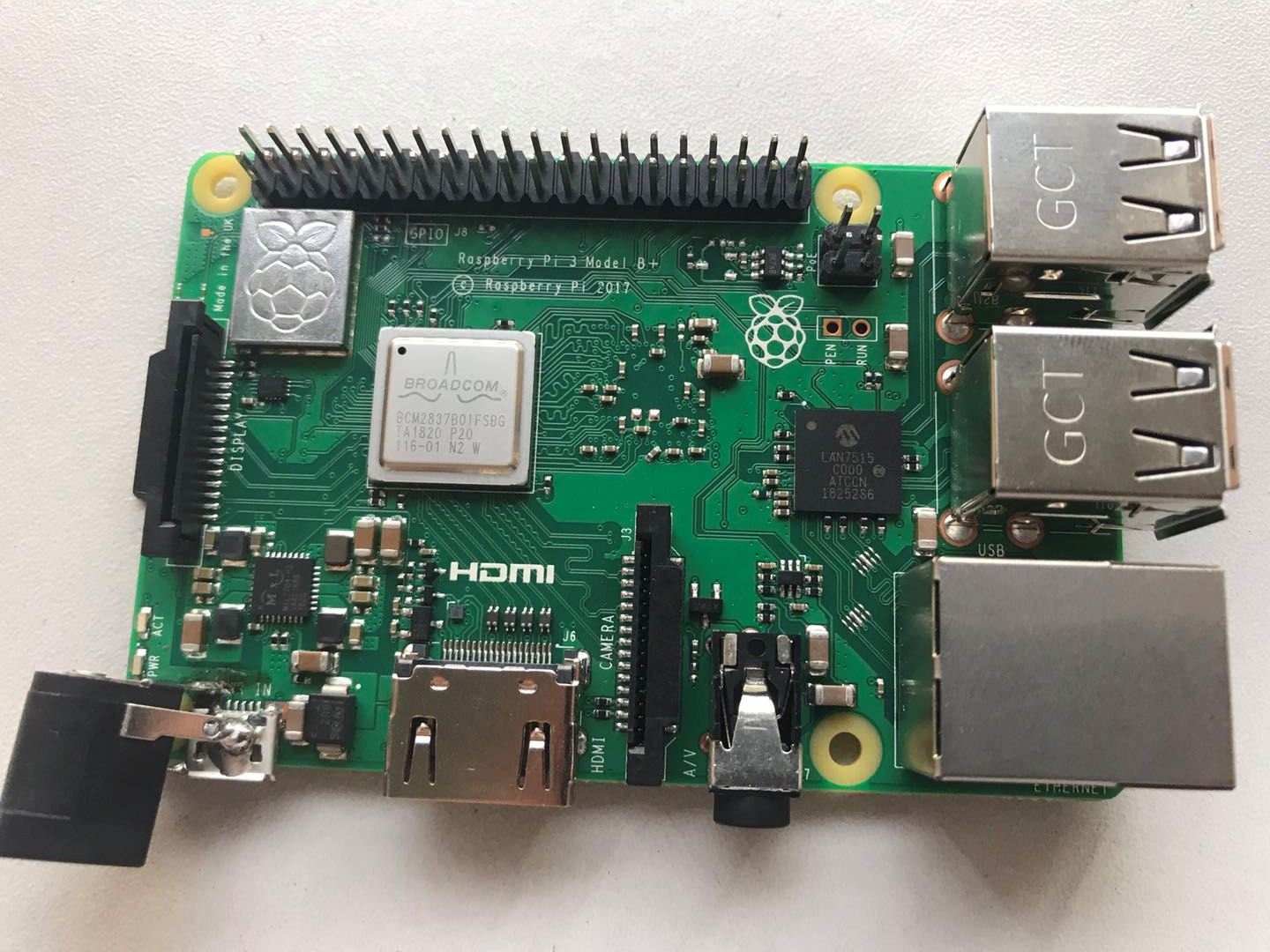

Good news that we success compile the latest open source driver for Raspberry Pi
Raspberry Pi 3 Moel B+

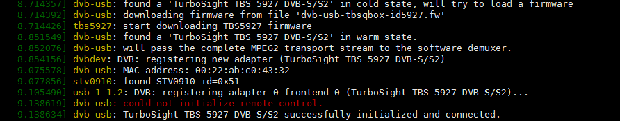

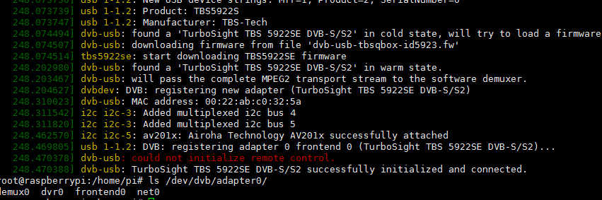

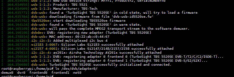

after reboot it should load the TBS driver.

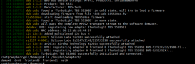

TBS5927:
RP-5927
TBS5922SE:
RP-5922SE
TBS5520SE
rp-5520se
if you have any issue you can leave message here . :)
