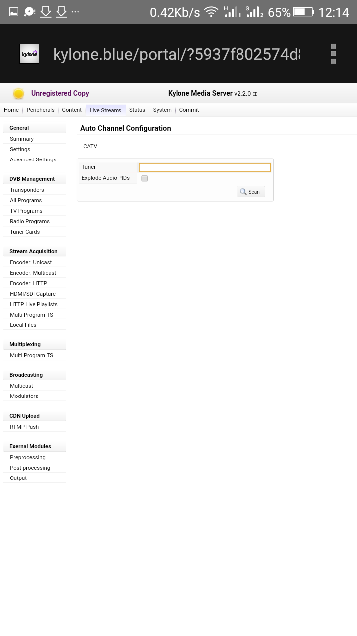

Hi.I install kylone and problems starts to apear:kylone does not recognise TBS6281SE tuner card.Any other cards like skystar dvb-s cards and dvb-c/t usb tuner card apear in configuring menu.(as in fotos)
Can anyone give me an solution?

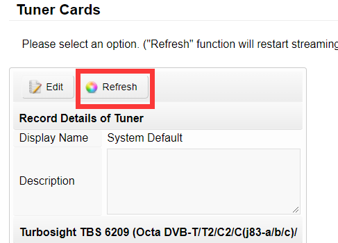

Please go to DVB managemange and tuner cards page press the refresh button :
Tuner Cards Refresh
