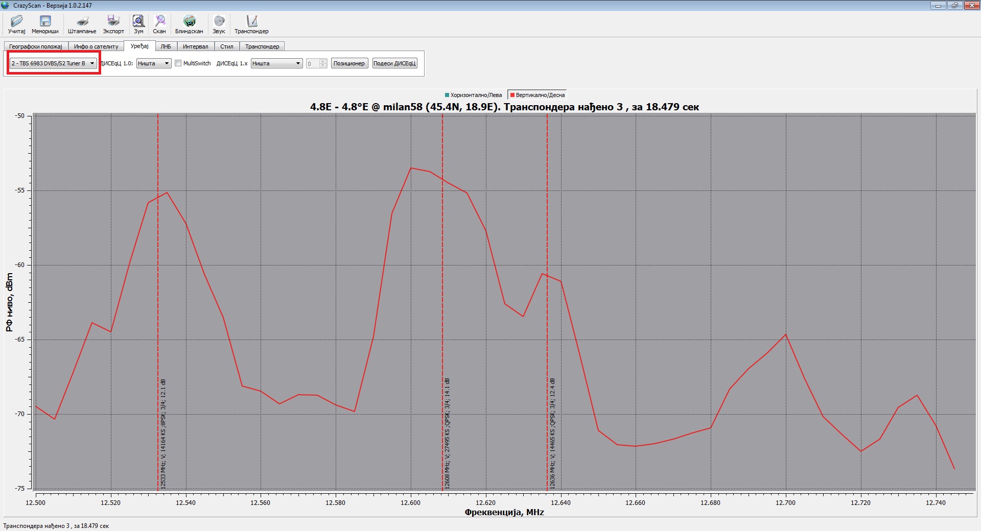

Postby milan58 » Tue Jul 10, 2018 7:30 pm
Respecting crazycat,
TBS6983 Tuner B scans only horizontal polarization with CrazyScan properly,when verifying the polarization scan, the true graph and frequency of horizontal polarization.
Where would be the mistake and can it be corrected?I installed a new card 12.1.2016,driver 1.0.0.7 for Windows.

Postby milan58 » Wed Jul 18, 2018 5:18 pm
TBS 6983 Tuner B scans only the horizontal polarization correctly,vertical polarization is not properly scanned(wrong)!
When scanning a vertical polarization, a graph of horizontal polarization is plotted.
Is it a mistake in tuner B or can you write a new driver?

I also have 6983 with same driver and not have this issue. You can check voltage on second input with some simple satfinder (connected btw card and dish cable) or with voltmeter ?

Thanks for the advice,there was a break in tuner B the horizontal polarization had a voltage of 0.4V.Measuring the voltage with the Digital Multimeter (I have measured several times) the voltages have been corrected so that the vertical polarization has 14,3V and the horizontal polarization is 19,0V.Now tuner B has recovered and everything works normally.
