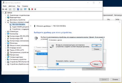

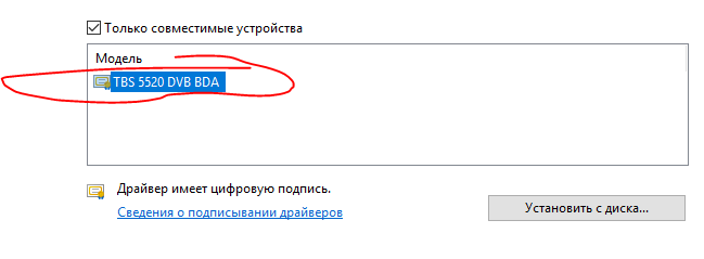

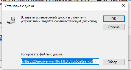

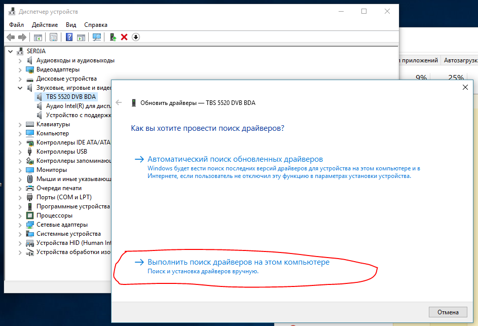

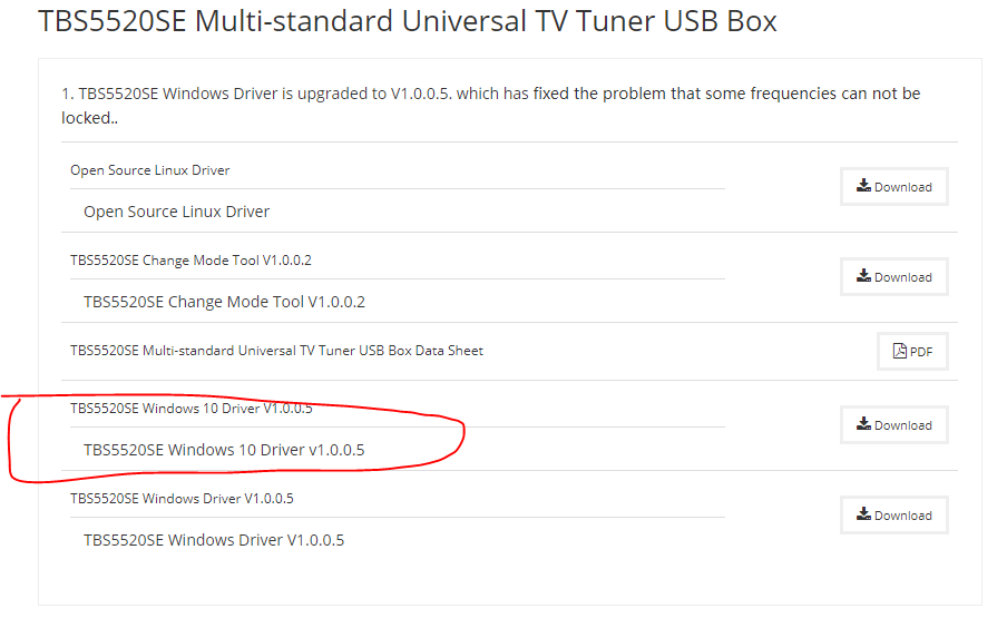

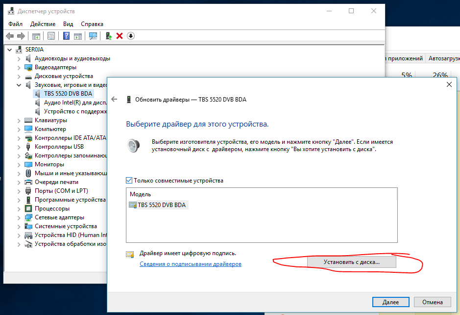

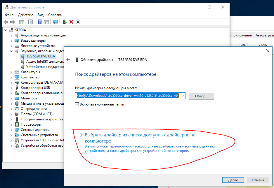

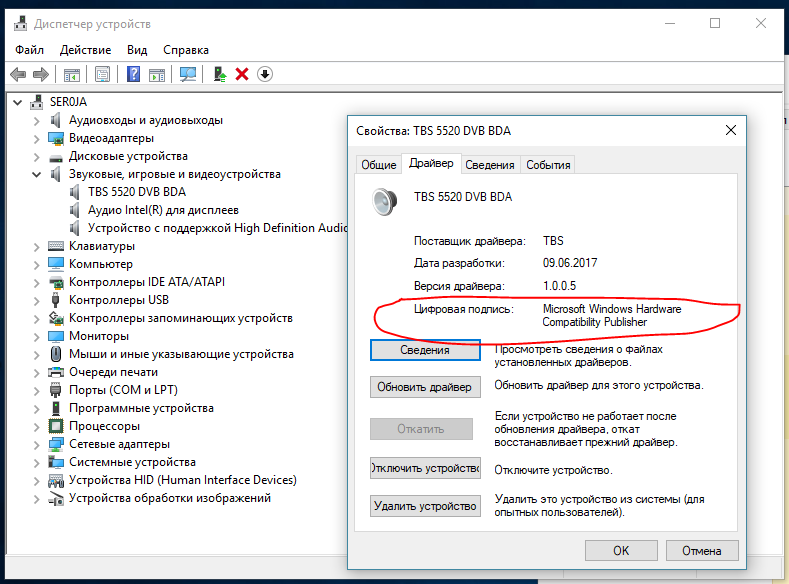

Postby Ser0ja » Sun Oct 08, 2017 4:58 pm
1
2

Postby gap30 » Sun Oct 08, 2017 9:17 pm
Thank you will give it a shot now and let you know the outcome

Postby gap30 » Sun Oct 08, 2017 9:53 pm
No luck just keep getting the access is denied message

Re: How to install drivers in Windows 10
Postby gap30 » Mon Oct 09, 2017 3:56 am
Bit of an odd one this, I could not for the life of me get the drivers to install and was given the access is denied message constantly
I then did a full reset of the PC and when i rebooted:
https://postimg.org/image/18qj79o16z/
Windows had installed the driver without me doing anything ie Test mode, disable driver verification etc
Now when I visit my father I can take my tuner with me, not sure what the answer is to the driver problems in Windows 10 but this is a quick workaround for anyone facing the same issues
