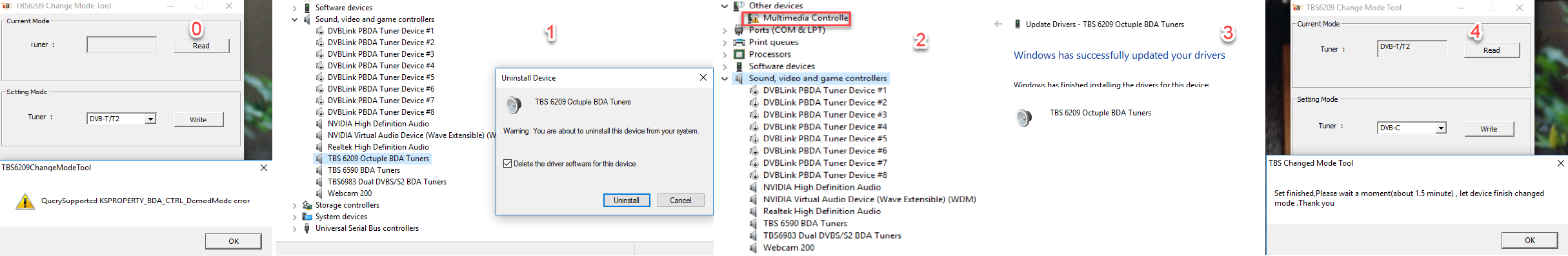

I completed the online support form. I tried the new driver, but still the same. The change mode tool also doesn't work I get the error "QuerySupported KSPROPERTY_BDA_CTRL_DemodMode Error"

darrensellers Wrote:I completed the online support form. I tried the new driver, but still the same. The change mode tool also doesn't work I get the error "QuerySupported KSPROPERTY_BDA_CTRL_DemodMode Error"
Here's what you need to do:uninstall the driver and then install it again,as you can see in the picture.Hope to help.
I am using driver version 1.0.0.2 - 27-Dec-16.

Postby darrensellers » Wed Oct 11, 2017 3:41 am
I uninstalled and reinstalled the driver. The switch tool now works, but the tuner still doesn't find any channels.
