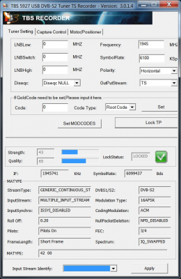

Postby slavarec » Wed May 24, 2017 4:19 pm
You stated that the device can write GS streams. This is not true!
I'm trying to write any GS stream through your TBS-TSRecorder, but on the way out I get an incorrect stream in which the byte 0x47 is always inserted.
Evidence:
TS Recorder Screenshot
Q-capture.zip
TS
(172.95 KiB) Downloaded 384 times

Re: TBS 5927 problems
Postby crazycat » Thu May 25, 2017 4:16 am
slavarec Wrote:You stated that the device can write GS streams. This is not true!
Device can stream all traffic from TS bus via bulk USB. But drivers align stream to TS packet boundary.
Postby steven » Mon Jun 05, 2017 6:14 pm
Hi bardoc
In TSRecorder setting set the output stream to GS and try again
Postby bardoc » Tue Jun 06, 2017 3:30 pm
Hi Steven,
Before you advise something, try it yourself.
Crazycat said that this is a problem in the device drivers.
bardoc
Posts: 10
Joined: Wed May 24, 2017 3:30 pm
