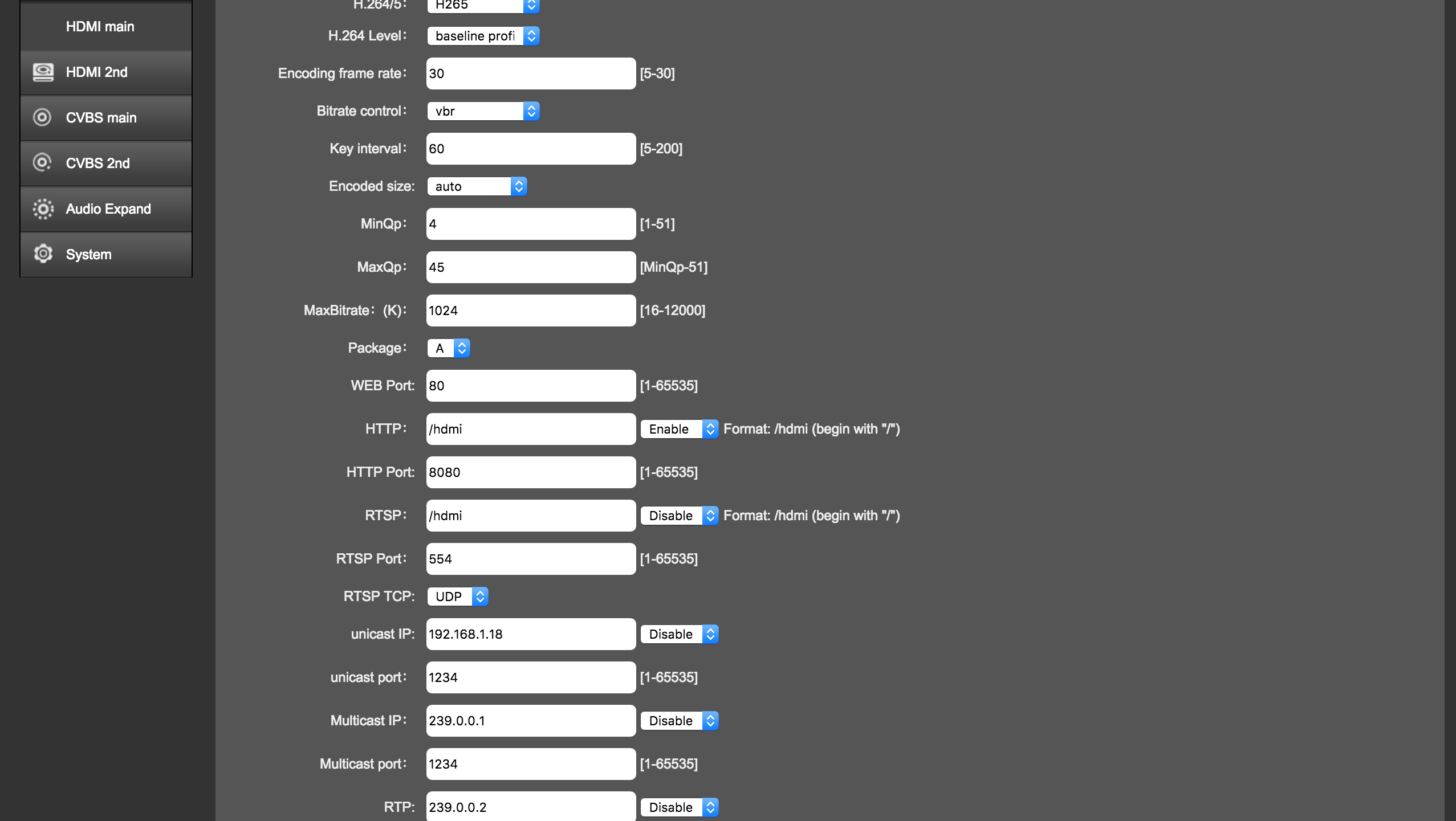

has anyone successfully got this to stream to a xtream code panel? it keeps dropping out every couple mins without fail, have plenty of bandwidth and using other brands work perfectly fine using the http protocol and using the latest 1.0.51 firmware any ideas?

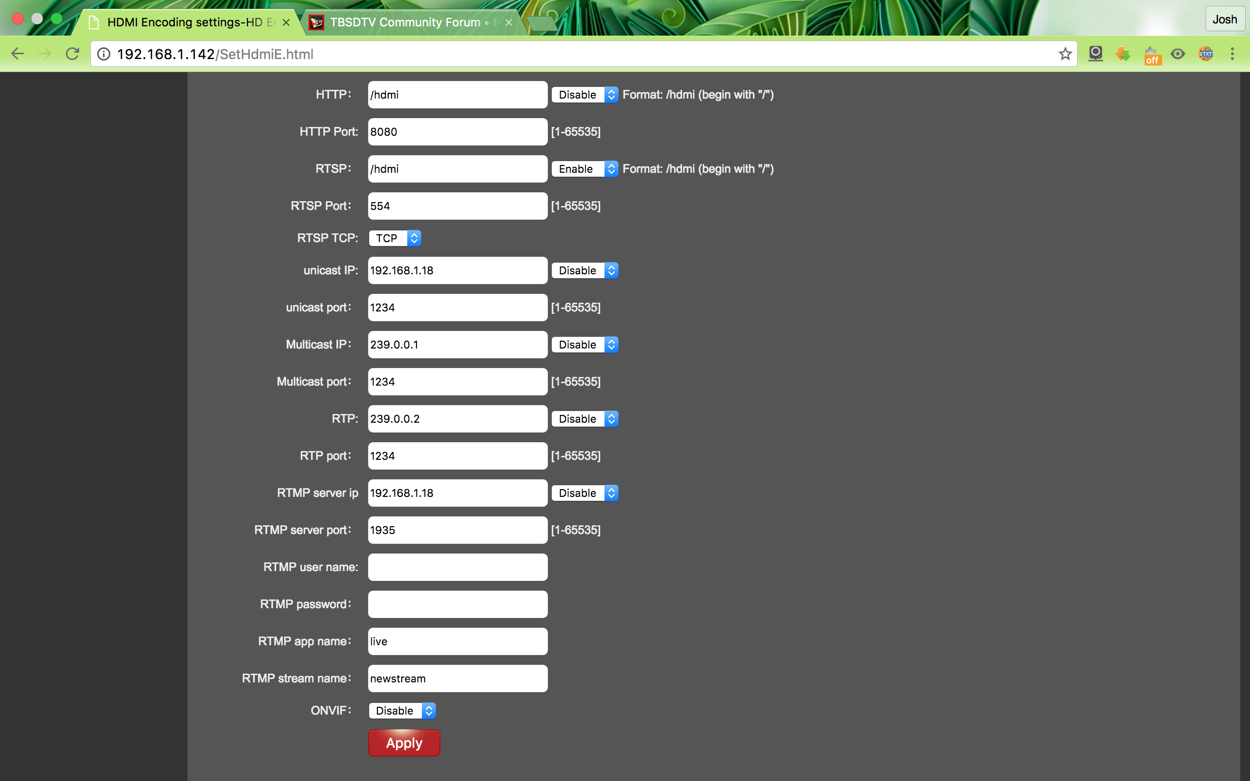

Thanks for your feedback can you have a try using rtsp with 2603 ?we are on working at our side too we set up the xtream-code server ,2603 using rtsp works well,and we will try our best to fix this issue when using http .

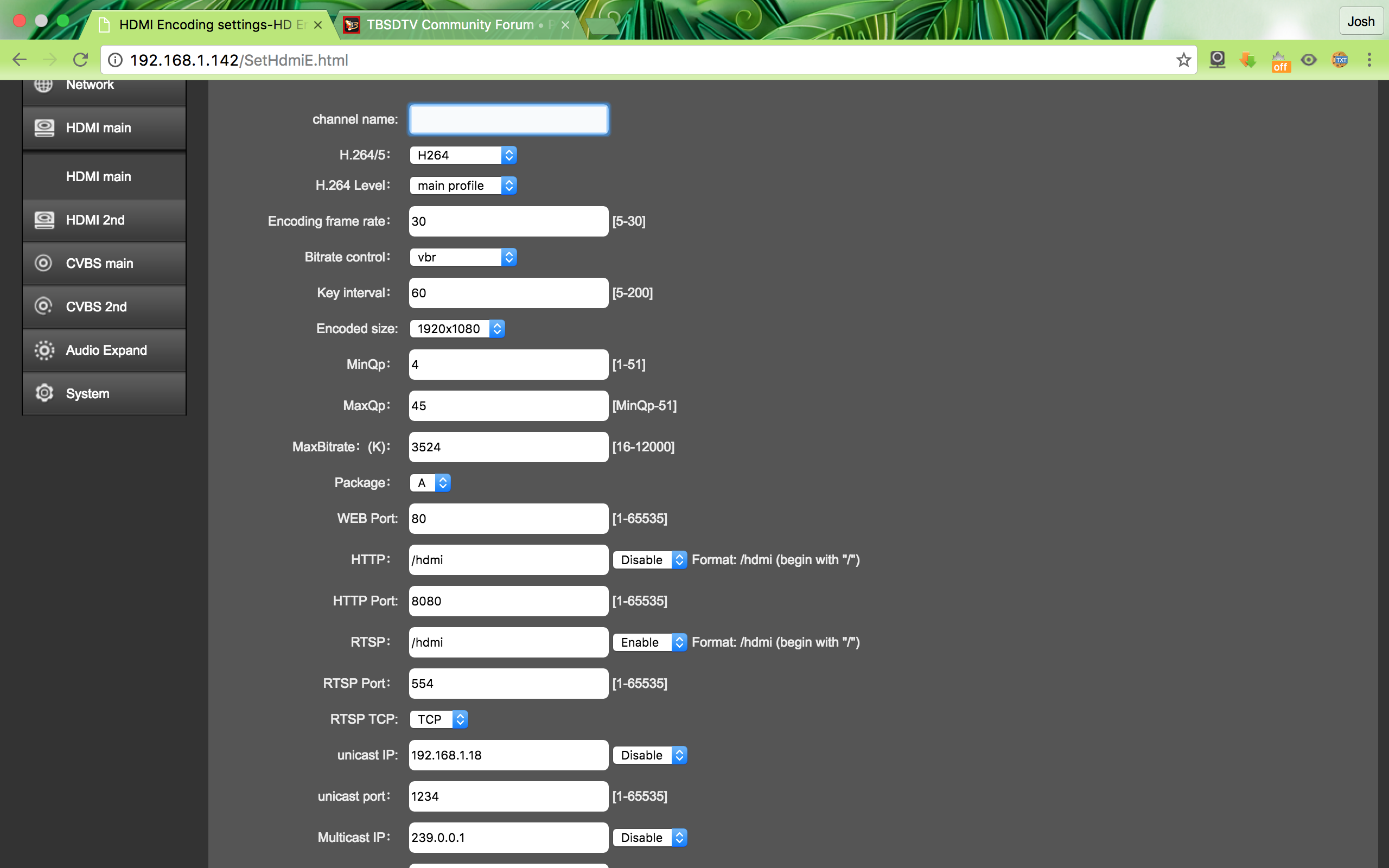

lads are doing great on the customer service very impressed, alright ive just set it up using rtsp and its solid streaming but the video is jumpy and jerky, ive used the exact same settings using http and its spot on, is there a difference between rtsp and http? the config ive uploaded below its just the basic settings from factory got tired of setting it custom with the resets i was doing haha

on follow up to my last message seems like rtsp isnt friendly with hevc, tried it with x254 and the jumping and jerkyness stopped
