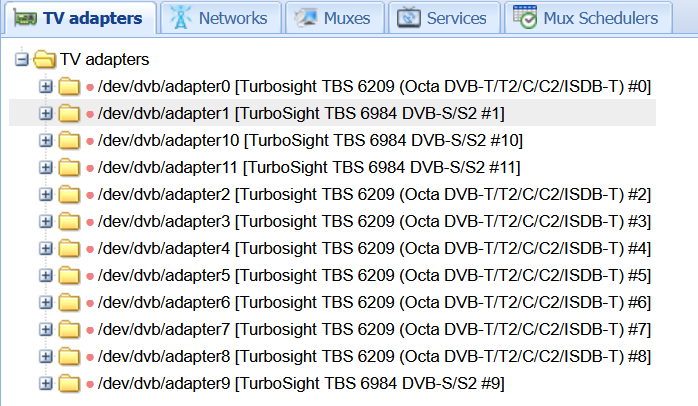

I have an issue with tuner order. They seem to load in a random order.

Can someone suggest a way to force the:
TBS6209 to take adapter_nr=10,11,12,13,14,15,16,17
TBS6984 to take adapter_nr=20,21,22,23
or similar.
Ideally (probably because of my ocd), I would like:
TBS6209-tuner 0 to be -> adapter_nr=10
TBS6209-tuner 1 to be -> adapter_nr=11
TBS6209-tuner 2 to be -> adapter_nr=12
TBS6209-tuner 3 to be -> adapter_nr=13
TBS6209-tuner 4 to be -> adapter_nr=14
TBS6209-tuner 5 to be -> adapter_nr=15
TBS6209-tuner 6 to be -> adapter_nr=16
TBS6209-tuner 7 to be -> adapter_nr=17
TBS6984-tuner A to be -> adapter_nr=20
TBS6984-tuner B to be -> adapter_nr=21
TBS6984-tuner C to be -> adapter_nr=22
TBS6984-tuner D to be -> adapter_nr=23
Can anyone suggest a fix before this drives me insane..

ls -al /dev/dvb
total 0
drwxr-xr-x 14 root root  280 Mar 10 14:07 .
drwxr-xr-x 21 root root 4920 Mar 10 14:07 ..
drwxr-xr-x  2 root root  120 Mar 10 14:07 adapter0
drwxr-xr-x  2 root root  120 Mar 10 14:07 adapter1
drwxr-xr-x  2 root root  120 Mar 10 14:07 adapter10
drwxr-xr-x  2 root root  120 Mar 10 14:07 adapter11
drwxr-xr-x  2 root root  120 Mar 10 14:07 adapter2
drwxr-xr-x  2 root root  120 Mar 10 14:07 adapter3
drwxr-xr-x  2 root root  120 Mar 10 14:07 adapter4
drwxr-xr-x  2 root root  120 Mar 10 14:07 adapter5
drwxr-xr-x  2 root root  120 Mar 10 14:07 adapter6
drwxr-xr-x  2 root root  120 Mar 10 14:07 adapter7
drwxr-xr-x  2 root root  120 Mar 10 14:07 adapter8
drwxr-xr-x  2 root root  120 Mar 10 14:07 adapter9

Postby steven » Sun Mar 21, 2021 8:18 am
Hi Sir
You can assign some adapter nums for certain adapter driver. Put this options to/etc/modprobe.d/dvb.conf
options saa716x_core adapter_nr=0,1,2,3
options tbsecp3 adapter_nr=
So saa716x-based 6984 always attached as adapter 0,1,2,3. Other FPGA-based cards 4,5,6,7......
after create the file do not forget to reboot .
