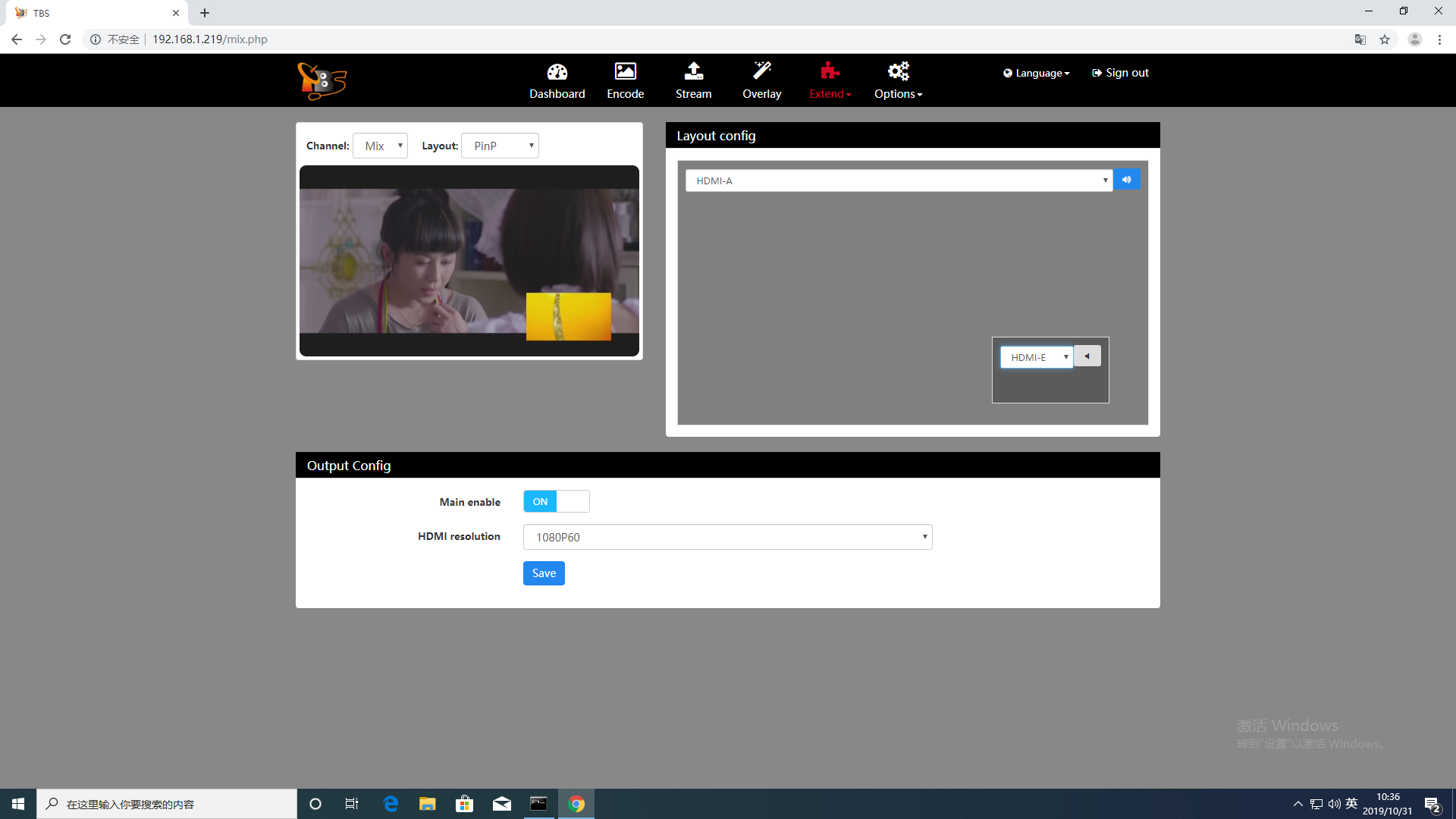

Hi poddingue,
I think TBS2605 "video mix:picture in picture" should be stuitable for you, i'll show you in a picture.
And the time which switch from "2 HDMI source mix and display in Picture in picture type" to "only one source input" is very short. If i didn't get your point, please correct me.

Postby poddingue » Thu Oct 31, 2019 5:08 pm
Thanks. The problem with PiP is that the second picture is small. What I'd like to do is having the second picture as big as the first one, but with transparency.

Postby daowei » Fri Nov 01, 2019 12:50 pm
poddingue Wrote:Thanks. The problem with PiP is that the second picture is small. What I'd like to do is having the second picture as big as the first one, but with transparency.
Here is an example of a second HDMI source that I would like to add on top of the other:
https://www.youtube.com/watch?v=tJ5iwglxxgA
It looks like what I'm looking for is keying, compositing, mixing, or alpha blending.
https://www.deltacast.tv/technologies/keyer
Hi poddingue,
Thanks for your informaiton. I'll check link, and talk with my colleague to evaluate whether we can do it.

Postby daowei » Tue Nov 12, 2019 2:26 pm
Hi poddingue,
Hi poddingue,
Sorry for delay.
Just checked the Youtube video, the specification of the "Keyer", and talked with my team. It's a little difficult to make is come ture in Encoder currently. It's needed another specified software and hardware for this i think.
