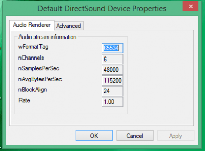

Attached are 2 streams as seen by TBSViewer :
- No sound
Stream when no sound

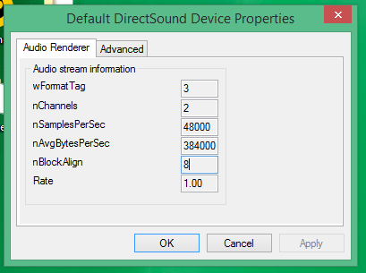

- Sound ok
Sound Ok
