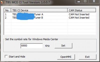

Use special TBSCITOOL to set the symbol rate for Windows Media Center.
http://www.tbsdtv.com/download/document/tbs6680/tbs6680-virtualdvbt_mcecitool_v1.0.0.7.zip
like this:
Set_symbol_rate

Re: How to use DVB-C in Windows Media Center with TBS6680
Postby Berzerkr » Fri Jul 04, 2014 3:00 am
Pictures in first post are missing and I dont know how to set symbol rate?
Can you please put those images up again or explain me how to set symbol rate so I can find some channels in MCE?
Postby Berzerkr » Sat Jan 03, 2015 5:28 am
Hi Steven!
Please repost those pictures so I can get my card working!!
Postby Pierrick » Sat Feb 21, 2015 3:02 am
Hello,
I am also a TBS6680 user.
Actually, it works pretty well with MCE !
As explained, simply follow this steps :
1. Install the Virtual DVB-S Driver
2. Restart your machine
3. Install MCE CI Tool (Version 1.0.0.9 is fine with me) and do not close it ! just minimize.
