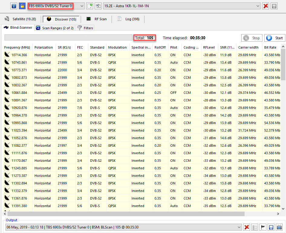

Re: TBS 6903-X blind scan
Postby s0nnenschein » Thu Jun 27, 2019 12:51 am
I have a similar "noise pattern" like the one at 11,2 horizontal in this image posted some posts before.
. Image
Is this a card issue? I have never seen this with all my other TBS cards.
s0nnenschein
Posts: 24
Joined: Sat Jun 09, 2018 4:38 pm
Postby satesco » Sun Jun 30, 2019 9:17 pm
It is not an issue of the card,but the fact that the chip does not support fast-scan.@CrazyCat has tried to solve this issue with his application,but it does not depend on him or TBS,but on STiD135's STMicroelectronics(?).But even under these conditions,which does not depend on CrazyCat,his application can scan and find the active frequencies.
satesco
Posts: 95
Postby s0nnenschein » Sat Jul 06, 2019 2:17 am
Thanks for the explanation. I already thought that it might not be TBS's or crazycat's fault.
s0nnenschein
Posts: 24
