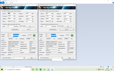

Any chance to improve the drivers? Several users request that already.
The card does not work properly although it's called professional. :cry:
- It detects GSE as Enhanced (see screenshot attached)
- I cannot select MIS on certain transponders (compared to 5927)
- card is slow
- no BlindScan2
- no complete BBFrames
- shows zombie signals (or mirrors of other transponders) in Crazyscan
- have to reinstall the driver after each windows start, otherwise the DVB application freezes
Attached file is from 23.5East, left TBS6903X, right TBS5927.
Comparision of same TP with 6903x and 5927

Update
Seems a small hardware modification (22uF capacitor) solves some issues.
https://www.satellitescommunity.de/foru ... #post39361
