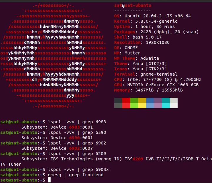

Postby satesco » Wed Jun 02, 2021 4:09 pm
Hi Steven,
I have the same problem that those who posted above,namely,once the dvb drivers are installed on ubuntu 20.04,and working fine,the resolution changed from 1920x1080 to 1280x768. I managed with difficulty,after an upgrade to the graphics card,to return to the initial resolution,but now Ubuntu sees cards but without drivers.Now I'm afraid to reinstall them,so that the same problem with the resolution does not return,as the first time.
I have to say that two times I reinstalled Ubuntu 20.04 version,believing that I made a mistake somewhere in the process of installing the tbs drivers.Unfortunately I did not manage to solve the problem. For now I have the correct monitor resolution but without the tbs drivers installed.What do you think I should do,to wait until a forum colleague comes up with a solution to the reported problem or go back to unbuntu 18.04,when everything was working fine?
Here is Ubuntu 20.04 (kerner5.8.0-50) with tbs cards.
Regards
satesco
Posts: 95
Re: tbs-open-linux-driver swipes Ubuntu 20.04 graphics drive
