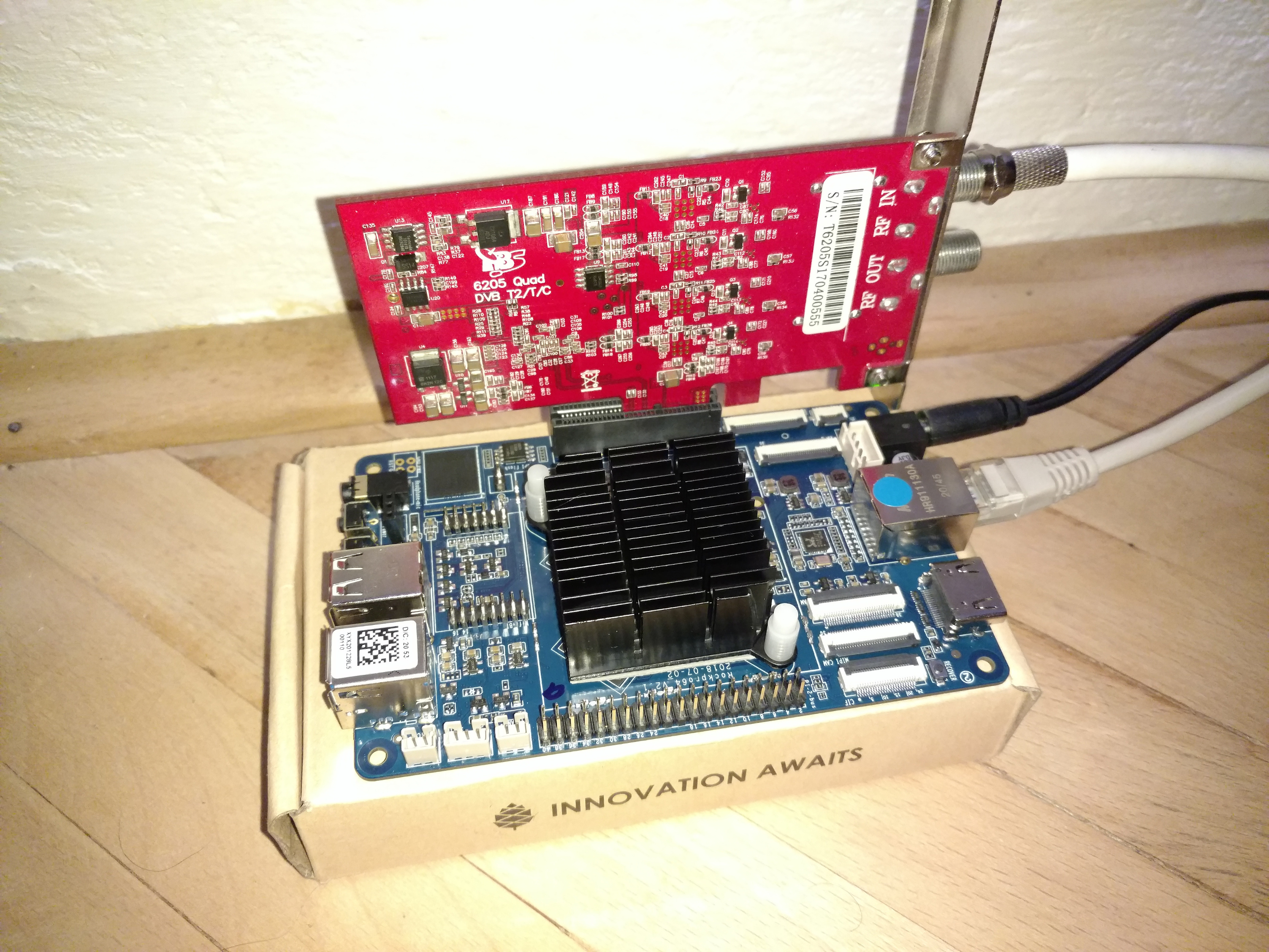

Postby Trupik » Wed Mar 31, 2021 1:22 am
Hey!
Success! RPi package looks like useless with Rockchip based devies (standard offline package is x86 only), so i tried to build new drivers from sources. It's not easy, under ARM, but with big help of Google I was able to build my own driver 8-)
Some info for other people:
HW setup:
  • Pine 64 RockPro64, 4GB RAM, 6core RK3399, PCIe x4,...
  • 32GB eMMC
  • Tuner TBS 6205 (PCI based quad DVB-T/T2/C)
  • Noname 12@4A wall adaptor
SW setup:
  • Armbian Buster 21.02.3 - for Rockpro64 kernel 5.10.21
  • Open Source drivers
* - Armbian with 4.x kernel isn't able to boot with this TV tuner in slot.. :shock:
Building process is very simillar to "standard" process described in Git Wiki.
In my case step "make -j4" failed with two errors about missing file rkisp1-config.h. This file isn't in media_build/linux/include/uapi/linux, but in /home/scritch/tbsdtv/media/include/uapi/linux/
Tried to copy this file to right folder with:
cp media/include/uapi/linux/rkisp1-config.h media_build/linux/include/uapi/linux
but without succes (I dont know why this failed) - so i copy this file step by step like cp media/include/uapi/linux/rkisp1-config.h ../ to the "/" folder and from here again step by step to right folder.
From now - command "make -j4" can finish his job without error :mrgreen:
NOTE: compiling is soo sloooow and CPU get soo hot! Don't forget about cooling!

From now i have nice, powerfull (but energy efficient) TV -> LAN straming server for my living home. TV Headend based. With much better image quality compared to my previous USB-based tuners server. Power consumption in idle is less than 7W (minimum what can my wall plug measure), 8-10W with one FHD channel streaming.
Sorry for ground picture - short cables :oops:
