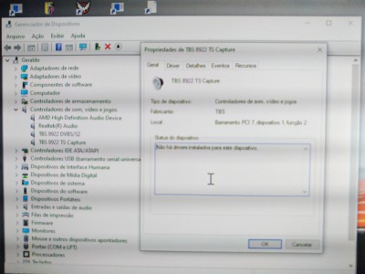

I wonder if anyone can tell me if I can use a C or Ku band antenna on input 0, and tune all transponders in polarization V and H. I already have the tbs 8922 card, I can't get it to work with windows 10 64 bit, Gigabyte B250m-d3h motherboard. It has a signal, but it does not save the frequencies. On the tbs 8922 ts capture it says "There are no drivers installed for this device". I've read everything on the tbs forum and it doesn't have a solution until today, it works with some and the other doesn't. And this is how it is today.

Postby Geraldo » Mon Aug 10, 2020 4:55 am
TBS 8922 TS CAPTURE

For 8922 issue you can setup a remote send remote information to our support we will have a remote check

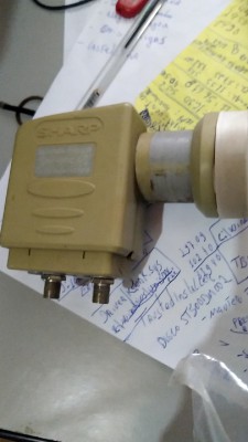

you can send email to our support , take one picture of your LNB let us check it is C or ku dual band .
For 8922 you can setup teamview remote .

Lnb Banda ku
I sent a message to support, about tbs 8922.
The lnb, band c has only one output, and is a single point. I didn't take a picture because here it is raining today.
