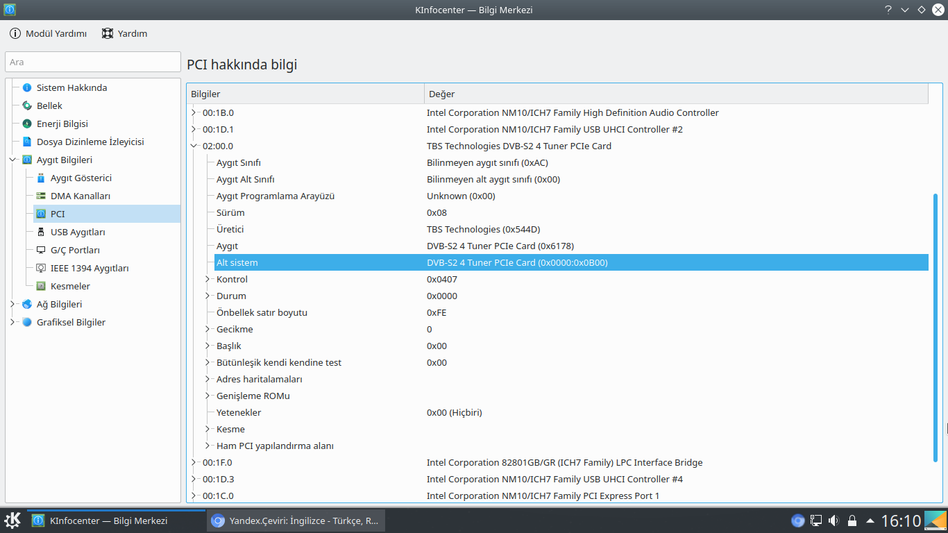

Postby ptergrand » Sun Nov 25, 2018 9:16 pm
driver dogru olarak yuklenmis mi

Postby ptergrand » Mon Nov 26, 2018 12:56 am
ptergrand Wrote:driver dogru olarak yuklenmis mi
star@star:~$ dmesg | grep TBS
[   17.908610] TBSECP3 driver 0000:02:00.0: TurboSight TBS 6903 DVB-S/S2
[   17.909290] dvbdev: DVB: registering new adapter (TBSECP3 DVB Adapter)
[   17.996209] TBSECP3 driver 0000:02:00.0: MAC address 00:22:ab:f0:be:72
[   18.311682] TBSECP3 driver 0000:02:00.0: DVB: registering adapter 0 frontend 0 (TurboSight TBS 6903 DVB-S/S2 )...
[   18.311800] dvbdev: DVB: registering new adapter (TBSECP3 DVB Adapter)
[   18.393124] TBSECP3 driver 0000:02:00.0: MAC address 00:22:ab:f0:be:73
[   18.393148] TBSECP3 driver 0000:02:00.0: DVB: registering adapter 1 frontend 0 (TurboSight TBS 6903 DVB-S/S2 )...
[   18.393269] TBSECP3 driver 0000:02:00.0: TurboSight TBS 6903 DVB-S/S2 : PCI 0000:02:00.0, IRQ 28, MMIO 0xfeac0000
star@star:~$
