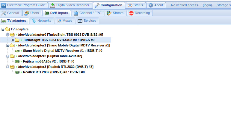

Postby frankviana » Thu Dec 10, 2020 11:43 pm
No working raspberry pi3 (rasp os 32bit)
root@raspberrypi:/home/pi# uname -a
Linux raspberrypi 5.4.79-v7+ #1373 SMP Mon Nov 23 13:22:33 GMT 2020 armv7l GNU/Linux
Tests with both media build:
media_build-2020-09-23.tar.bz2 (after apt-get install raspberrypi-kernel-headers, patchutils and libproc-processtable-perl)
and
media_build-rpi-2020-01-03.tar.bz2
First option, compiling after long time, but no working too.
Ubuntu working fine this media build (media_build-2020-09-23.tar.bz2)
frank@frank:~$ uname -a
Linux frank 5.4.0-56-generic #62-Ubuntu SMP Mon Nov 23 19:20:19 UTC 2020 x86_64 x86_64 x86_64 GNU/Linux
frank@frank:~$
