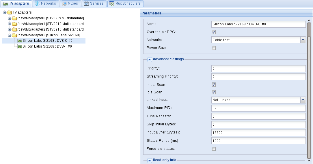

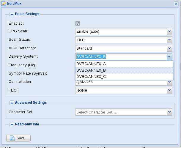

Newtman Wrote:I want report the excellent work of Crazycat, now I'm watching DVB-C Annex B (ATSC-C in TVHeadend now) and DVB-S2 only with the open source drivers :D
btw, stable TVHeadend 4.0.x show only DVB-T and C nodes for si2168. But in MUX config possible select standard as annex A,B,C
TVHeadend 4.0.x Si2168
DVB-C mux config
