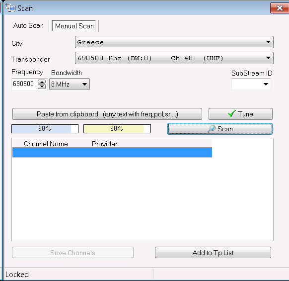

Postby Psilos » Mon Oct 26, 2015 3:40 pm
This is a screenshot of the scan window of the oem dvbdream 2.6 p3 from the tbs download page. I scanned a frequency with no signal. Yet level and quality of 90% are reported and also that the signal is locked (lower left). This happens for every frequency whether it has signal or not.
From dvbdream. Scan of a frequency wwith no signal.

Postby smile » Wed Oct 28, 2015 11:05 am
Hi Psilos ,
We are sorry for that,this is a bug.We will fix it .if you never mind,please use the current version driver for a while.
