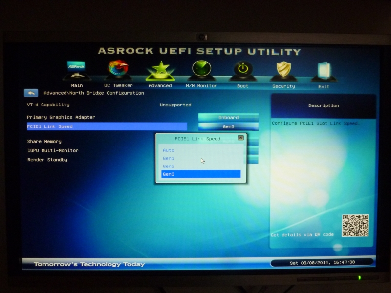

The very last message gave me the hint to check the dmesg for the TBS6618, and: I found no output that notes the DVB-C card. So I tried some modifications:
  1. Re-Install all drivers (sudo su, then goto install directory: cd /root/tbs/linux-tbs-drivers, finally make && make install), no success.
  2. Try all combinations of UEFI firmware for PCIe link speed: AUTO, GEN1, GEN2, GEN3 (see image attached). All of them with the TBS6618 in both PCIe slot #1 and afterwards in PCIe slot #2. No success.
I do not know how to proceed now. As you folks seem to be able to read all secrets from the logfiles :) I would like to ask you to have a look at the files attached and give me feedback which step I should go next.
Thanks in advance!

Photo of the UEFI setup screen

yes, i have Asrock B75M motherboard and all TBS cards (because 6618 uses the same PCIe interface as the rest) work in all PCIe slots on that motherboard - connect to the CPU directly or not. the only thing necessary is to set "PCIe Link Speed" in BIOS manually to prevent auto-detection from failing.
