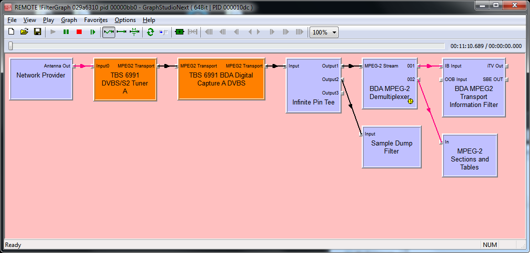

Hi everybody!
Trying to use raw BDA-methods (Win 7 Pro x64, Qt/C++) to work with tuners TBS 6991 on KazSat 3 58.5°East! Setting (run graph, tune request) is successful, the signal quality is 100%, but I see only free (not encrypted) programs! Directshow-graph is in attach.

So here are the questions:
1. When to call StartCI: before graph-filters are connected, after graph-filters are connected but before run graph, after run graph but before tunerequest submitted, after tunerequest is submitted?
2. When to call sendPmt: before run graph, before tuneRequest is submitted, after tuneRequest is submitted?
3. What version of PMT is correct for sendPmt (see attached PMTs.zip)? I try all of them, but none has been able to decrypt!
Please, help!

Postby slavarec » Wed Aug 10, 2016 3:04 pm
Ok, i've got it! Problem was in PMT, I had to use API Monitor to view the transmitted data to sendPMT-method in DVBDream.
