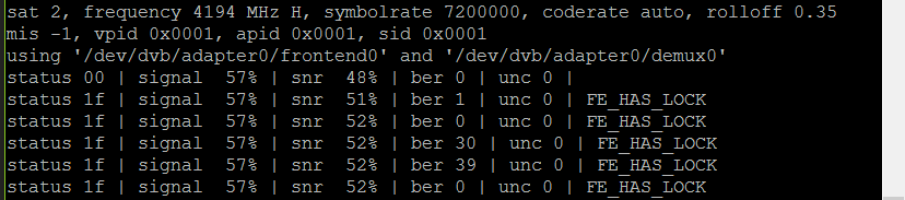

Hi, someone could please point me into the right direction here? I need to get the signal strength from the TBS 5925 tuner in decibels. I've tried with szap-s2 but this shows me % which is totally useless! Either if you know an application that will do this directly or have that piece of C code that would do the trick, that would be awesome.
I'm attaching a screenshot from szap-s2 with those strange values that aren't really telling me anything (that includes weird BER numbers)...

use dvb-fe-tool -m
but need install open-source drivers - https://github.com/tbsdtv/linux_media/wiki
P.S. Open-source stv090x driver report legacy SNR(%) = SNR(dB) * 5, Strength(%) = 100 + RFLevel(dBm)
