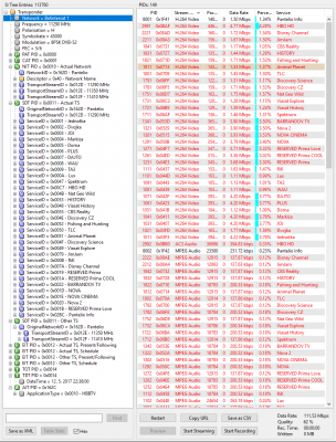

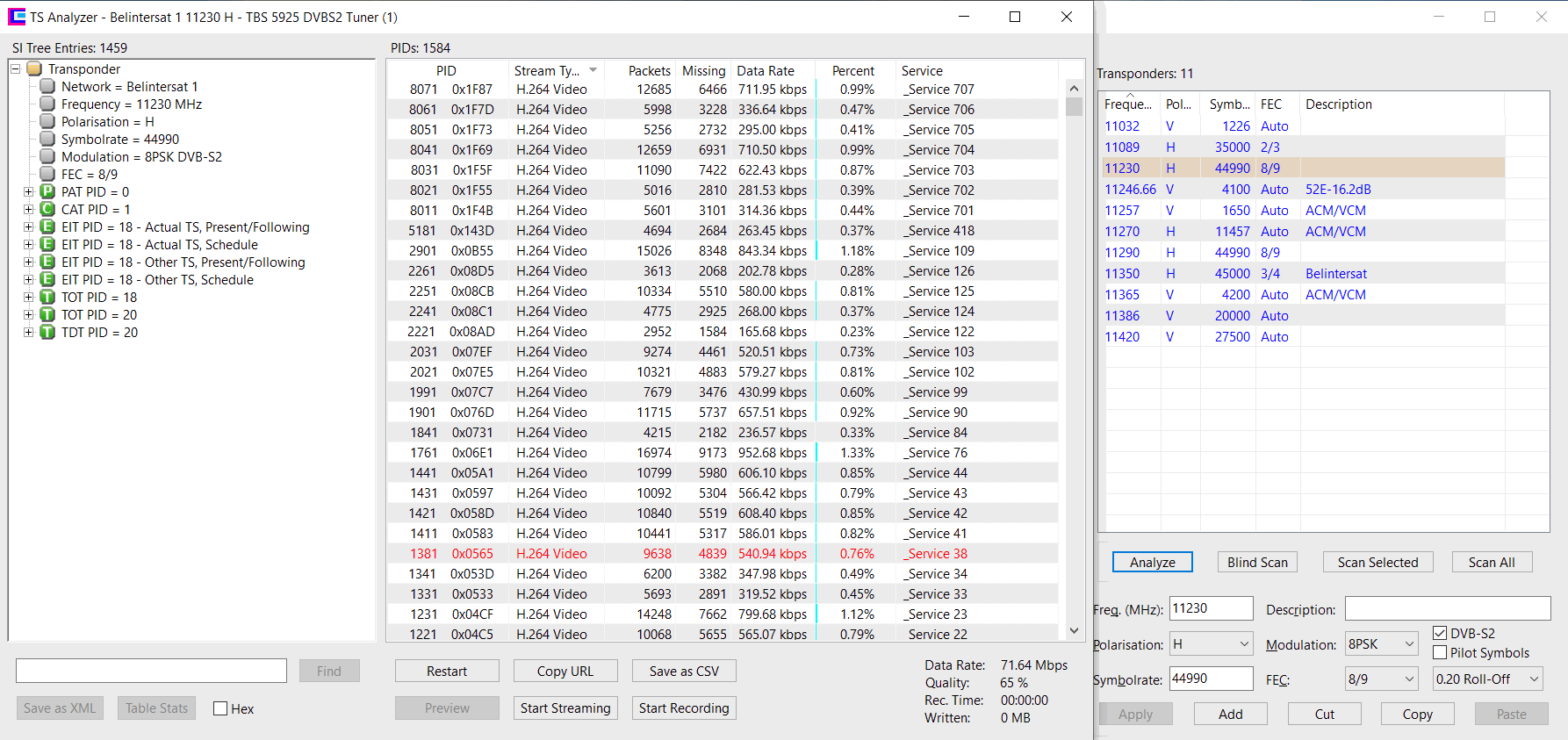

HI, maybe verified maximal bitrate for card ?
Now on 51 East Fotelka TV tested transponder with 120 MBit, but stream from card not OK (before with 111 MBit card work OK)
PS: TBS5927 same problem
before
now

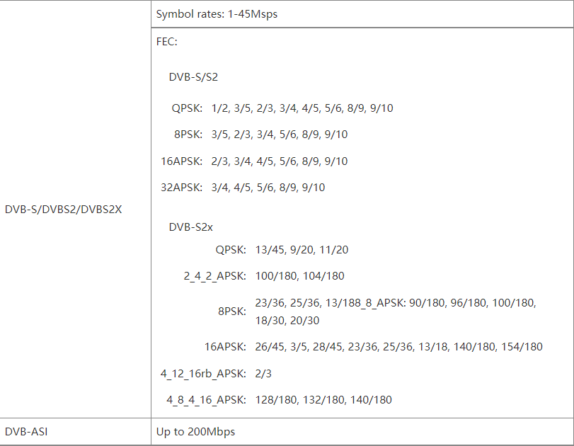

steven Wrote:Thanks for your detail feedback for 5927 the max is about 111.6Mbps limited by the UBS port too
PS: Does the 5590 use the same USB port? So how does ASI process input up to 200Mbps?

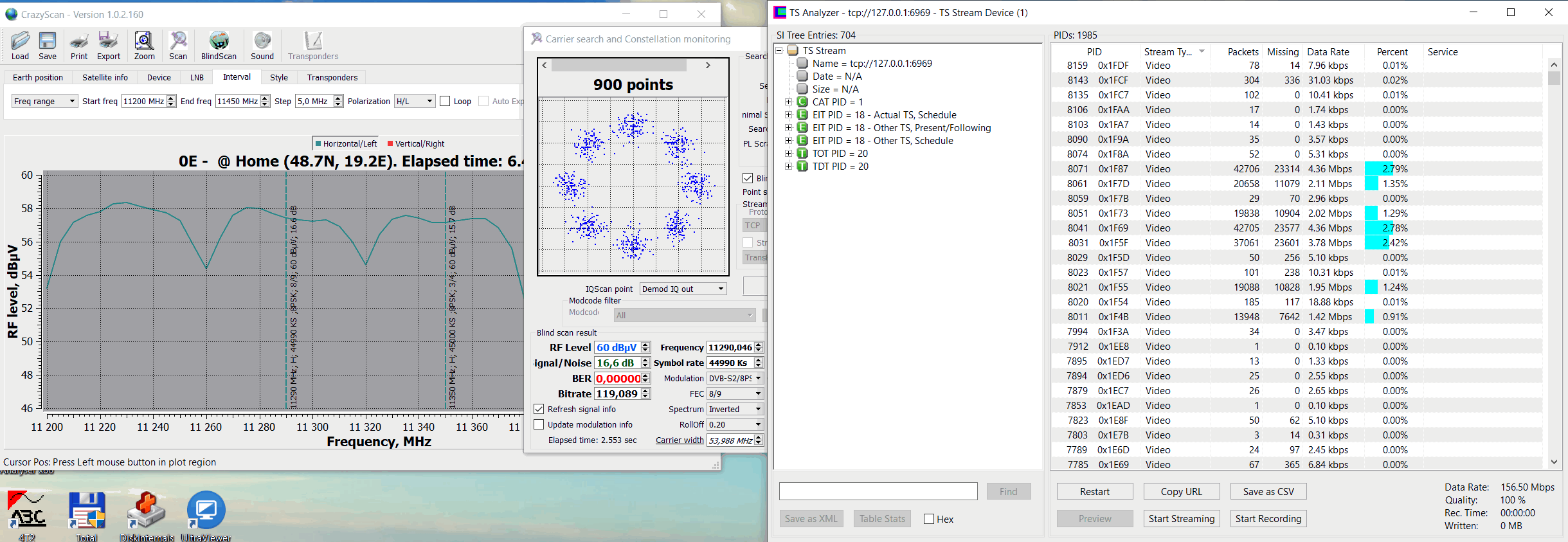

Postby EnoSat » Sun Nov 27, 2022 11:51 pm
if the TBS5590 uses the same output as the TBS5925/5927, it is interesting that it processes 119 Mbit
https://youtu.be/F6zegDVHNd0
Worth to mention that this was modified and now says 120 Mbit instead of 200 Mbit ;)
https://www.tbsdtv.com/products/tbs5590 ... probe.html
Anyway still interesting - I've got 5520SE, but if 5590 is better, maybe it's time to exchange. Beside LED diodes and ASI there's no differences from specification point of view, so if there is a difference, might buy.
