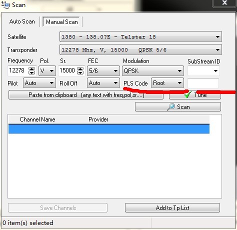

For the DVBDream's problem we have found that it has send the wrong parameters.
If you know your PLS value ,please manual set it here:
Root Gold Code
After set the right parameters you can lock the PLS transponder.
This problem we have contacted with DVBDream next version we will fix this problem.
