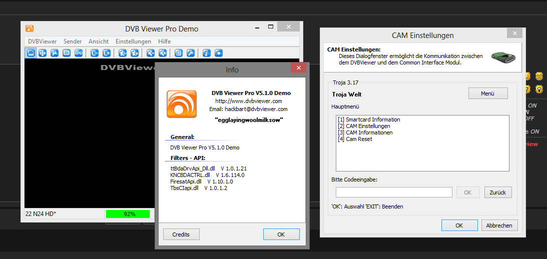

Postby Patrick291188 » Wed Aug 21, 2013 12:38 am
Still encrypted in DVB-Viewer and windows media center. I saw on another TV cards distributors that needed a fix "Fix UNICAM EVO 3.0 CAM compatible issue for CI products". Have you already tried this cam?
