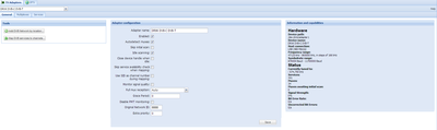

Hello All,
I have a strange problem.
After installing the TBS drivers for the TBS5922 i lose all other DVB adapters.
I have a plain ubuntu 13.04 server installation with Tvheadend installed
and installed prerequisite packages
apt-get update
apt-get install linux-headers-`uname -r`
apt-get install linux-source
Iconnected 3 DVB USB adapters
- 1 x DVB-C usb terratec H5
- 1 x DVBSKy S960 DVB-S/S2 USB
- 1 x TBS5922 DVB-S/S2 USB

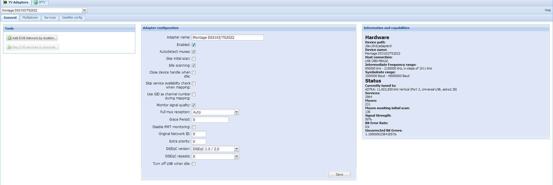

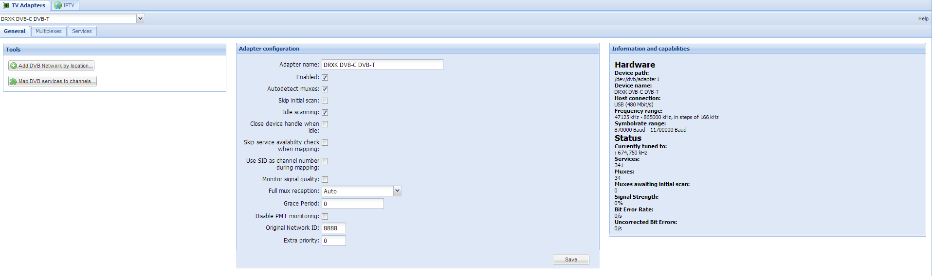

After installing 13.04 and tvheadend i compiled the drivers from DVBSKy S960 DVB-S2
After a reboot the DVB-C usb terratec H5 & the DVBSKy S960 DVB-S/S2 USB works great.
See
dmesgv1.zip
(15.8 KiB) Downloaded 683 times

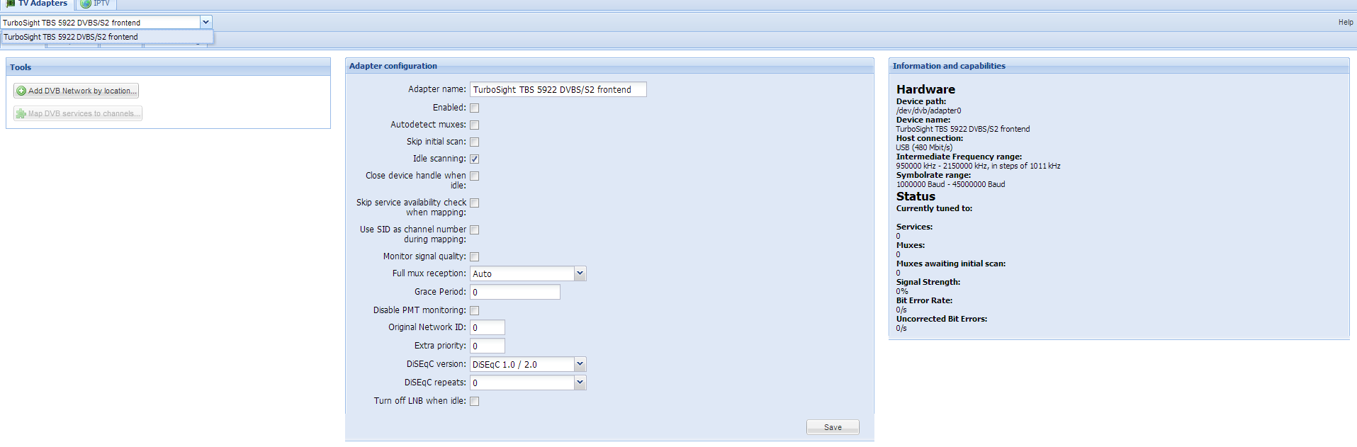

After compiling drivers tbs-linux-drivers_v130506 i lose DVB-C usb terratec H5 & DVBSKy S960 DVB-S/S2 USB
the only card that i see is the TBS5922 DVB-S/S2 USB
See LOGFILES:
Logs after unstalling tbs-linux-drivers_v130506.zip
(23.03 KiB) Downloaded 687 times
Is there any solution for this problem???
Please let me know.
