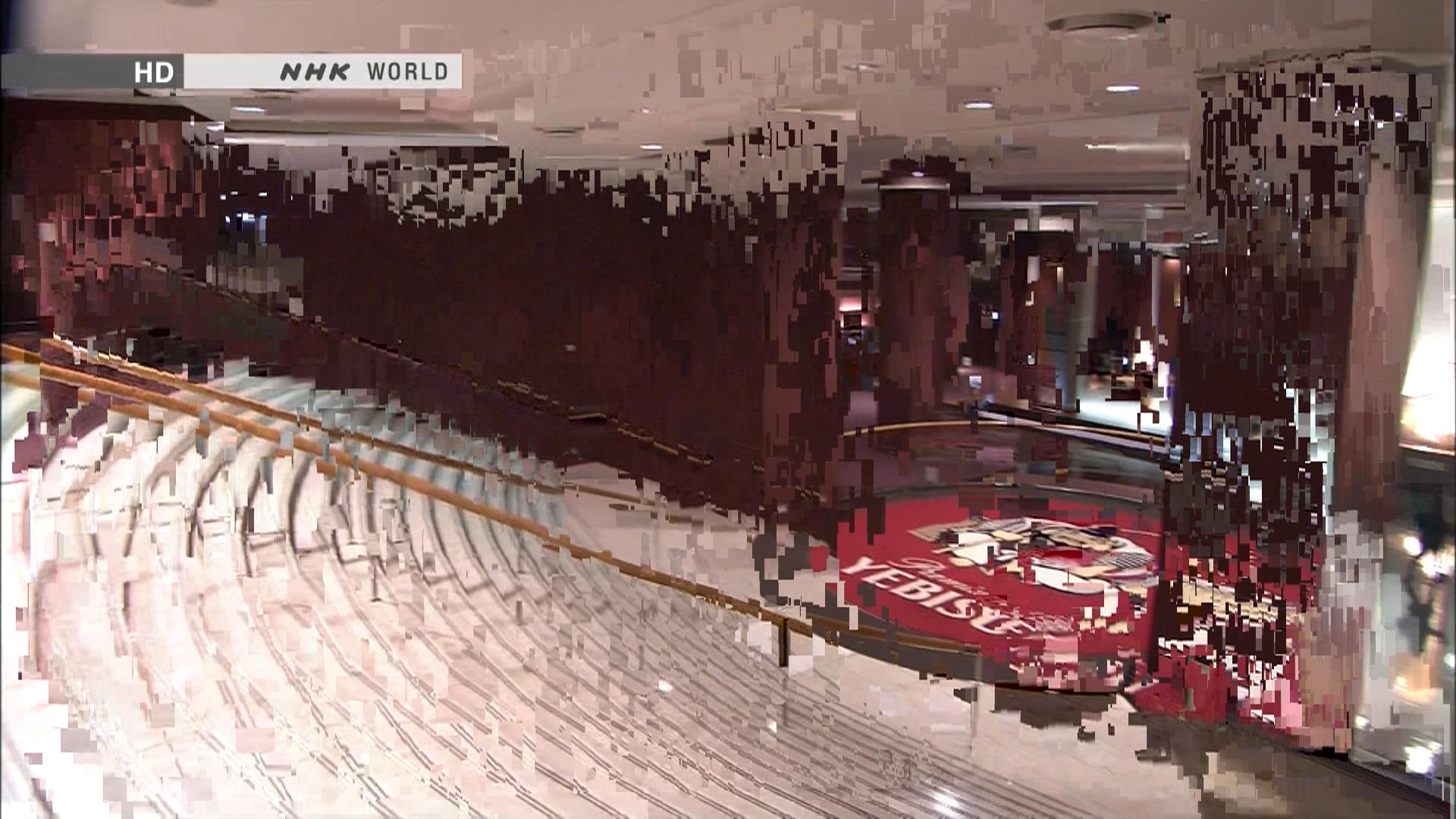

The loss rate is not so high to be seen at naked eye, but its effect is fatal on the recorded files. If you keep on watching the live picture you can get the pixelation as in the attached image.
The satellites used for the test are Eutelsat 28A (Super beam) and Astra 19.2E on 120cm and 100cm dishes, Northern Italy, clear sky.
