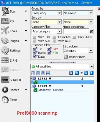

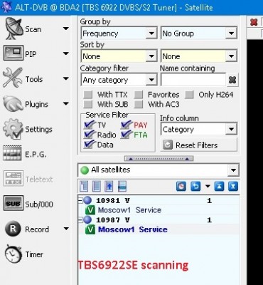

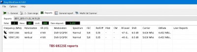

I discovered an annoying bug with 6922SE. I scanned 10E with TBS6922SE and Prof8000 and Easy Blindscan(and Crazyscan). I have got these two freq with both card: 10981MHz V 4167 and 10987MHz V 4167. Same report with both cards. I scanned these two freq with AltDVB and DVBDream.
Here is surprise: I got same service name on both freq with TBS6922SE: only 'Moscow1 service'.
But I got two different service name with Prof8000: 'Moscow1 service' and 'SDUP5'.
I got same picture with 6922SE and different picture with Prof.
I checked again these frequencies and the results were same(AltDVB, DvbDream). I used same LNB, same dish, same cable.

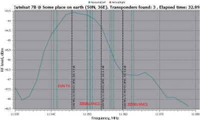

Crazyscan is working very good and give me official frequency parameters. You can see it on attachment picture.
If i scan these frequencies with dvbdream(altDVB), i get false services.
Here is my test results:
11045 H 4937 - ZZEBU ENC 2
11046 H 4397 - ZZEBU ENC 2 ---> ENV TV official frequency (Freq: 11046 H SR: 8333)
11047 H 4937 - ZZEBU ENC 2
11048 H 4937 - ZZEBU ENC 2
11049 H 4937 - ZZEBU ENC 2
11050 H 4937 - ZZEBU ENC 2
11051 H 4937 - locking, but get scanning error
11052 H 4937 - ZZEBU ENC 1
11053 H 4937 - ZZEBU ENC 1
11054 H 4937 - ZZEBU ENC 1 - ->> ZZEBU ENC2 official frequency
11055 H 4937 - ZZEBU ENC 1
11056 H 4937 - ZZEBU ENC 1
11060 H 4937 - ZZEBU ENC 1 -->> ZZEBU ENC 1 official frequency
11061 H 4937 - ZZEBU ENC 1
11062 - locking, but get scanning error
11063 - locking, but get scanning error
I have tested many (feed)frequencies and I got this conclusion:
DVB applications failed to scan with TBS6922SE, if neighbouring frequencies broadcast with same SR parameters(and SR is lower than 5000 Ks/s !!!!(6-7 MHz)). Different channels with same parameters, but DVB application give same service on both channel which service has higher RF level.
