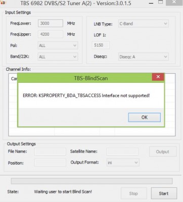

Hello,
About a year ago I purchased a TBS6922SE PCIe satellite card for my Windows 8.1 64bit computer. I connected the TBS6922SE PCIe satellite card to my satellite dish and was able to perform a Blind scan and receive satellite signals. A few months later I started getting an error message when the blindscan utility or any other satellite program was launched. I tried both the original drivers that came with the TBS card and currently have the latest drivers for TBS6922SE PCIe satellite card installed that I downloaded from this site. The Error Message I get when I launch the TBS Blindscan "TBS-Blindscan Error: KSPROPERTY_BDA_TBSACCESS Interface not supported!" (See attachment). I have spent weeks on this and tried everything I could think of including uninstalling all TBS satellite and all other Satellite software with no luck. I even reinstalled the Windows 8.1 64bit operating system and came to the conclusion I had a bad TBS6922SE PCIe satellite card. I then purchased a new TBS6982 PCIe satellite card. I get the same Error Message I get when I launch the TBS Blindscan or any other satellite software: "TBS-Blindscan Error: KSPROPERTY_BDA_TBSACCESS Interface not supported!" (See attachment). I have even moved the satellite card into a different PCIe slot and only using One card at a time. The Message indicates a problem with the BDA driver. Does anyone know if there is another BDA driver I can try and where I can get it from? Does anyone have any ideas on how I can get either my TBS6922SE or TBS6982 PCIe satellite cards working. Any help would be appreciated. -Tom

Forgot to mention that the TBS satellite cards show up correctly in device manager so the drivers appear to be installed correctly.

Can you watch TV? If the answer is yes, then it's no problem of the card.
Try to put the TV card in another PC.

I get the same error Tom
but fortunately it still performs the blindscan after clicking the error away

which version of Blind scan tool you are using ? please have a try with our latest one :
http://www.tbsdtv.com/download/document ... _tools.zip

Thanks steven
that version seems fine, no errors reported
